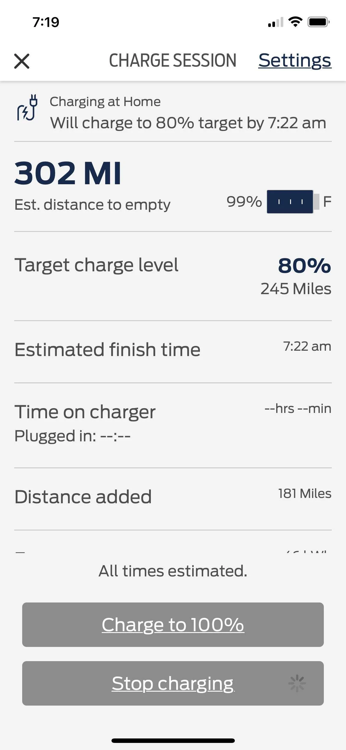

The SOC was at 50% when I scheduled the charge. All was fine in the car and I looked at FP to see if it matched and it did. I checked a few times in the evening just to be sure it didn’t change and all was fine. The charge time is fine 7kw an hour.
When I looked at schedule in the car this morning it said charge to 50%.
When I saw my smart meter in the red at 7am I looked at FP and it said target charge of 80% had been achieved but it was on 99% and still going. I hit the Stop Charging button on FP but it still carried on charging. I had to go and pull the plug out.
I can’t win. FP and car screwy. It’s going back to the dealer again next week and they are talking about replacing some module.

Still showing FP screen shots which are really not relevant to how the car is working? Who cares what the app says or does not do at this stage as long as the car works as expected. Go out and hit the stop button on the car and quit using the phone is my first recommendation.
You have now set the schedule up in the car? Deleted it, reestablished it as a new location and set the schedule in the vehicle again to see in that helped.
Car was going to 100% is the problem and did not stop at 80%. Not sure if it started on schedule at 12 am.

FordPass status is not great unfortunately. Usually it's charged perfectly fine it just didn't update the server appropriately.
This is what happened to me me recently.
