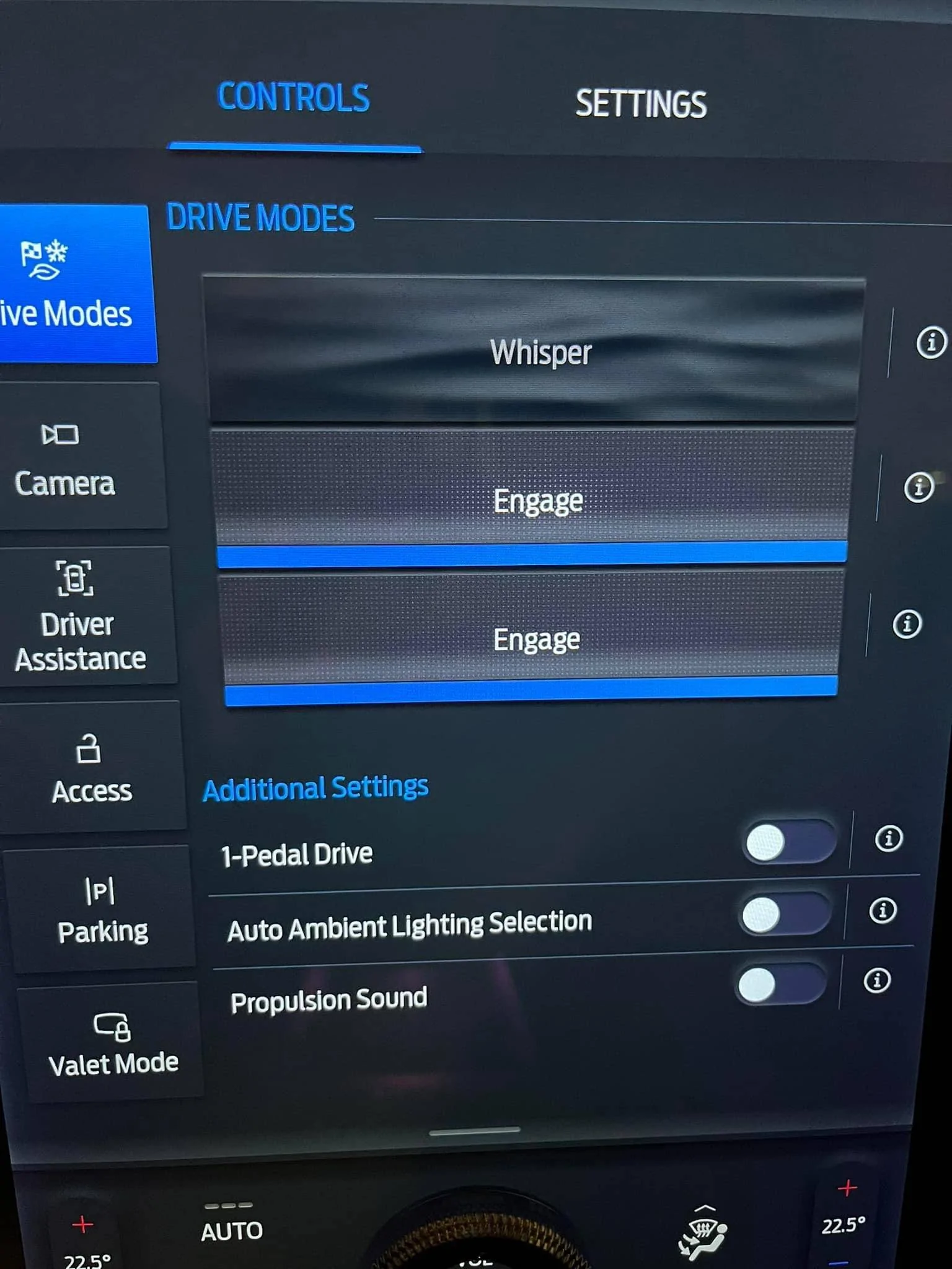

Noticed this after 3.6.1 update. Did a reboot of sync a few times but can’t get unbridled back ?

You have one Engage mode, yes, and now you have second Engage mode. Don't you know about second Engage mode?

I've experienced this once or twice. If rebooting SYNC doesn't work, you could try disconnecting the 12V battery for 5 to 10 minutes and then reconnect. That can help to get all the modules talking to each other properly before. (Note that I didn't need to do that to get Unbridled to come back - I don't recall exactly what I did do, but I think the SYNC reboot worked.)
