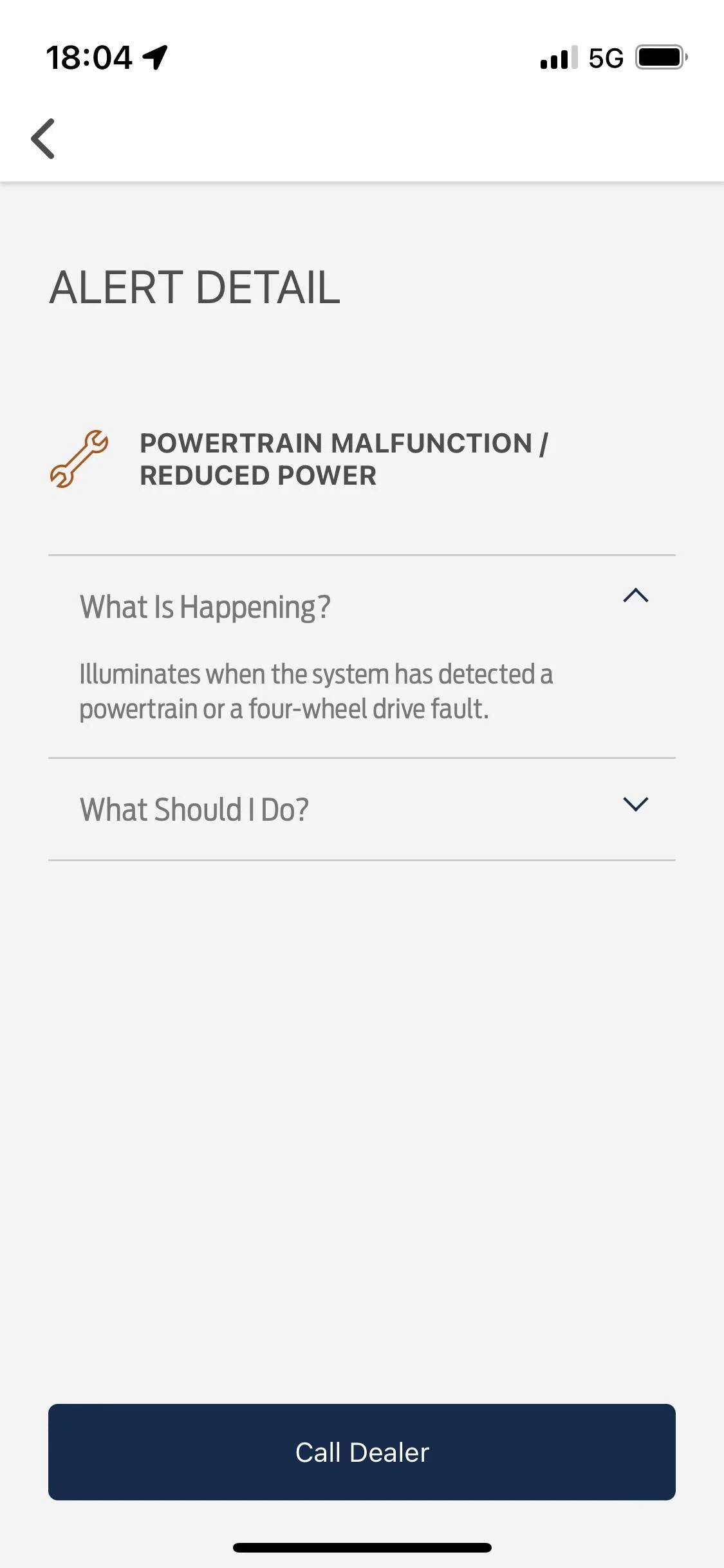

This error popped up for me as well today. I was driving around town on a very short trip (< 10km), decided to put it on Unbridled Extend for variety and the Service Vehicle Soon/wrench icon showed up. I also got the error message on FordPass. 1 Pedal driving was disabled as expected for Unbridled Extend, but power was not limited.
The next time I started my car the wrench was gone. The FordPass message cleared off my Home Screen after an hour or so.
I’m gonna hold off on scheduling service and see if I learn more here.
