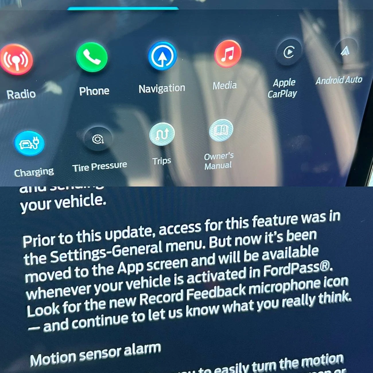

Recently I got 6.20 update saying about Recording feedback icon moved to the app screen.
But I could not find it on the app screen. Even there is not recording feedback in the settings-general menu.
anybody knows that where it is?
Thanks.

I tried doing that. But it didn’t work at all. Thanks.

Sounds like the “charging assist” / “public charging” app, which is a myth. Some have it, some don’t, and likely Ford don’t understand their own software enough to know why some does not have it ?

If you have FORScan, check this line in the APIM and make sure that 4 is there at the end of the first block.
7D0-10-04000400004130
