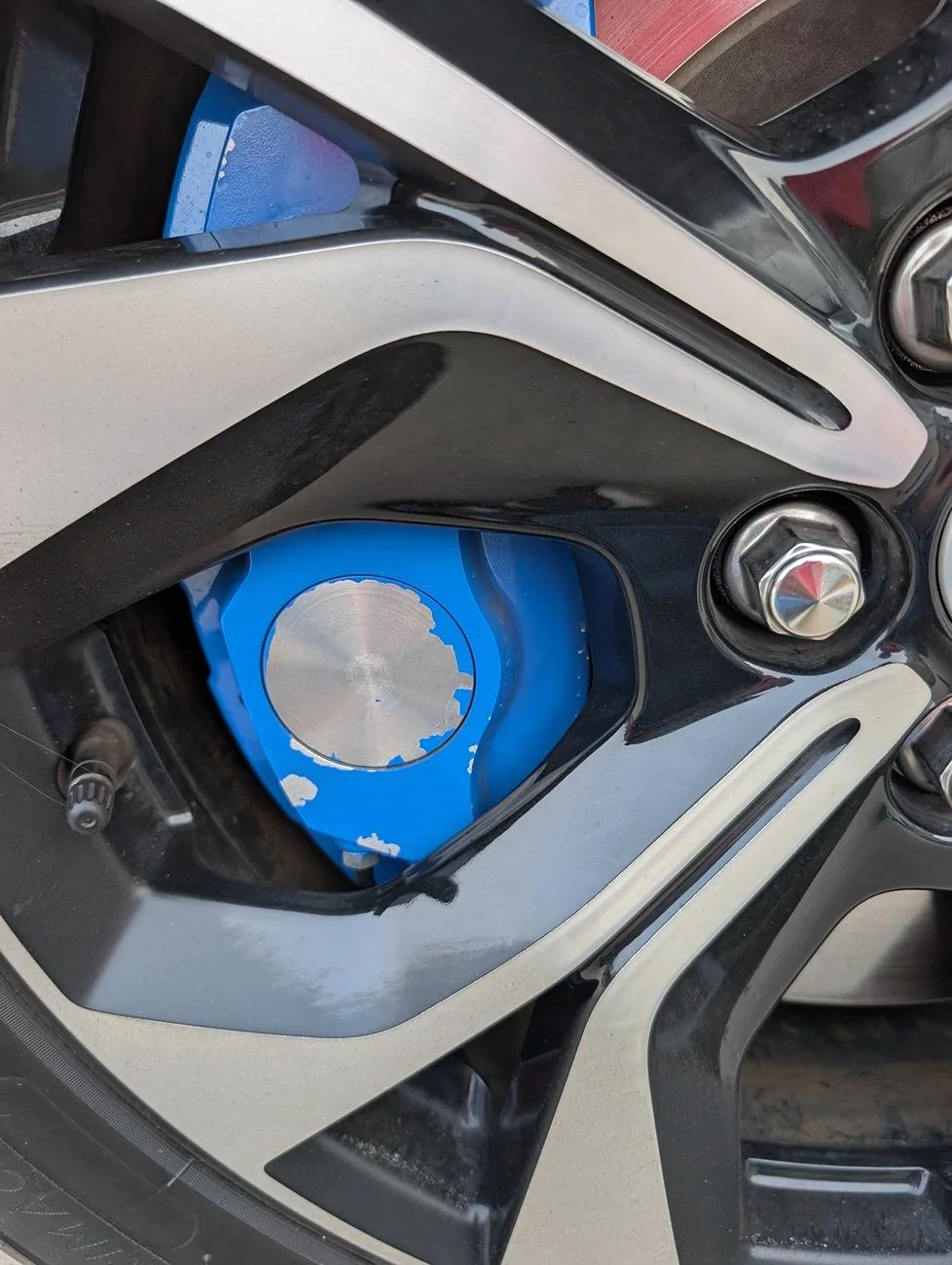

Why does my caliper paint keep chipping off here?

This is just the caliper plunger, so I'm wondering if it turns when it activates? I also hardly ever use my brakes, so maybe it just never bakes on properly. wondering if anyone else has this happening.

Isn’t it like billet steel or aluminum? Very hard to get paint to stick without proper preparation. Light sanding/scuffing to give the paint something to stick to and a proper primer.

That’s an odd place to lose paint, just 1 or all 4? If just the one I’d think a leak. If all of them I’d think just not cleaned well enough. I ended up polishing mine because I wasn’t going to paint them. I had to polish because ‘iron off’ made them look terrible when it came into contact with that area. It stained them black so there was some sort of reaction, perhaps a SOS pad them a bit and use rubbing alcohol before the next try.
there is adhesion products like BullDog (fyi smells like hell). The caliper body is cast aluminum, those plungers I think are stainless steel.

It’s made from aluminium. Did you use the right paint?
There are no moving parts on the outside..

Lack of prep and no primer.
Last mach-e I wet sanded, and rinsed off with brake cleaner.
use an etching primer, then paint, and clear-coat.
wet sand between coats as necessary
nothing moved after 2 1/2 years ish
