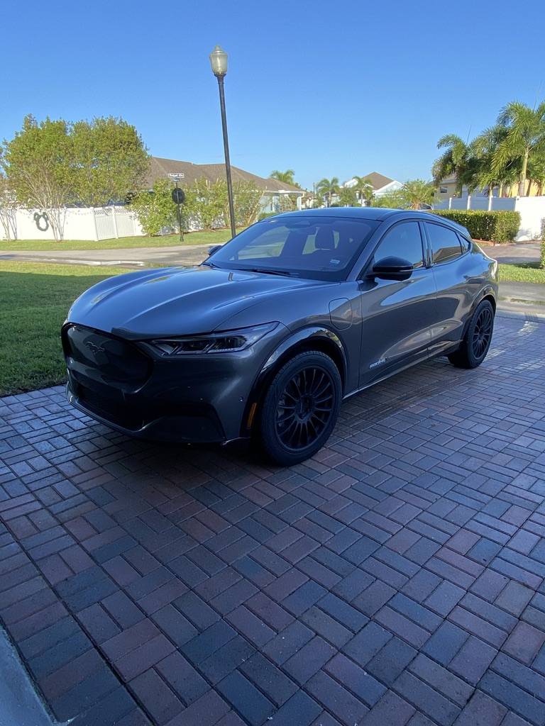

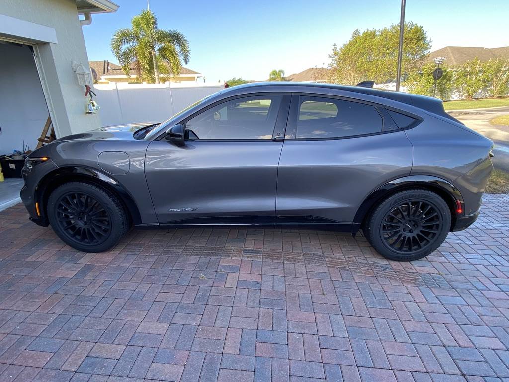

I just put new wheels and 255/45/R20 tires on my premium ER AWD and the handling seems better than the OEM ones.

It seems like its a little smoother but the handling in my opinion is defiantly better. It wasn't bad before but I like the way it feels now.

Drive over/with/through some ruts on a freeway at speed and let us know how they deal with them.
what rims and tires are those? You can’t leave out the super important details!! ?
Edit-
ENHANCE!! -Goodyear is all I can tell

Wheels are Monaco vision 20 X8.5 5-108.00 35 BKMTXX satin black. Tires are GOODYEAR ASSURANCE COMFORT DRIVE 255/45 R20 105V XL SBL. I don't think I'll have any problems with these. The aspect ratio is about what the OEM's were.

Thanks. I’ve been eyeballing those rims on DiscountTire for a while. Good to see them mounted on a MachE

Nice! I am also running 255/45R20 tires and it definitely makes a difference, especially on high speed sweeping turns where there are some bumps. The 225/55 tires have too much sidewall flex and you get this kind of bouncy snap back feeling... with the wider low profile tires it feels much more planted.
