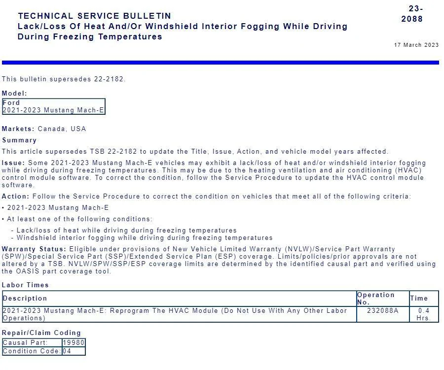

Actually this is a known issue. Ford has a Technical Service Bulletin for this.
Was this update ever done OTA? I am experiencing this issue on my new to me 23 MMY.
