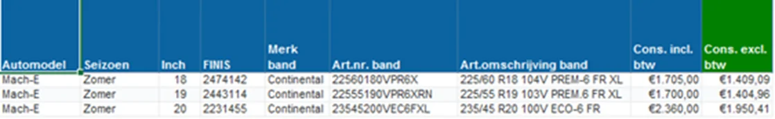

Anyone have an idea what the Ford part number is for the 18" wheels? All I could find is what appears to be the aero covers (1130).
I prefer to go with a second set of wheels for my winter tires and the 18" wheels would save some money on the tires (like $15 a tire) compared to the 19" wheels.
Ford Mustang Mach-E Winter tires 1608659141227

Thanks! I know people asked about the offset so this is from the description:
5-spoke Y design, Carbonized Grey
7J x 18", offset 47.5, for tyres 225/60 R18
We're getting closer. Now we just need the bolt pattern.
