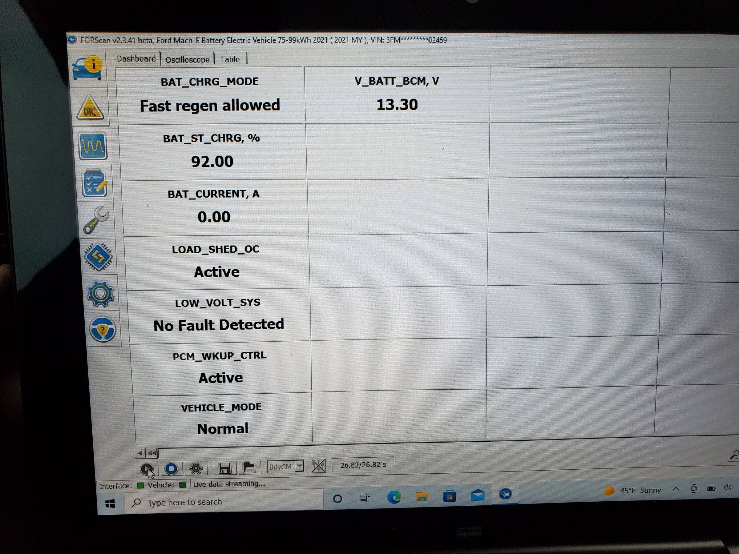

Any idea what the available choices are for Battery Charge Mode? I found this in the Body Control Module of all places....

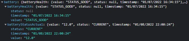

Yes. It it actually has a decimal but it's always 12.0, 13.0, 14.0, or 15.0
Either the car doesn't sent the decimal to Ford, or they strip it off when they display it back in your account.

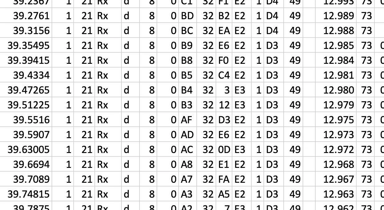

Funny thing is BMS reports LVB voltage via LIN bus, I think it was directly to BCM with 1 mV resolution! Every 40 mS (25 Hz) when MME is on, usually every 15 minutes when sleeping. BCM shares BMS LIN data with other modules over CAN bus. Here is a sample (time left (decimal seconds), LVB voltage to three decimal places right):

This is what my vehicle reports currently on my account. I also monitor it in HomeAssistant with the fordpass integration, it will just jump between 12 and 13
