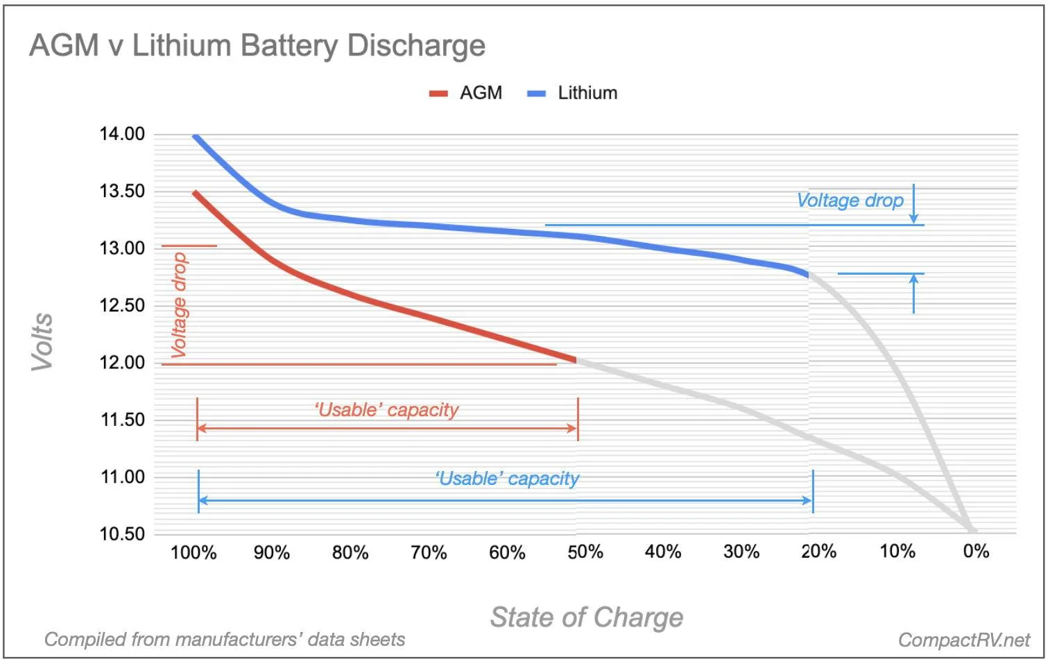

Yes, battery has to cycle a little bit to establish the capacity. But the delta V on an AGM is quite high such that a 90% to 50% discharge a couple times should provide plenty of capacity data.
Ford Mustang Mach-E 12V Battery Recharge Threshold Improved in Latest BCM Software! agm-lithium-discharge-chart-12
