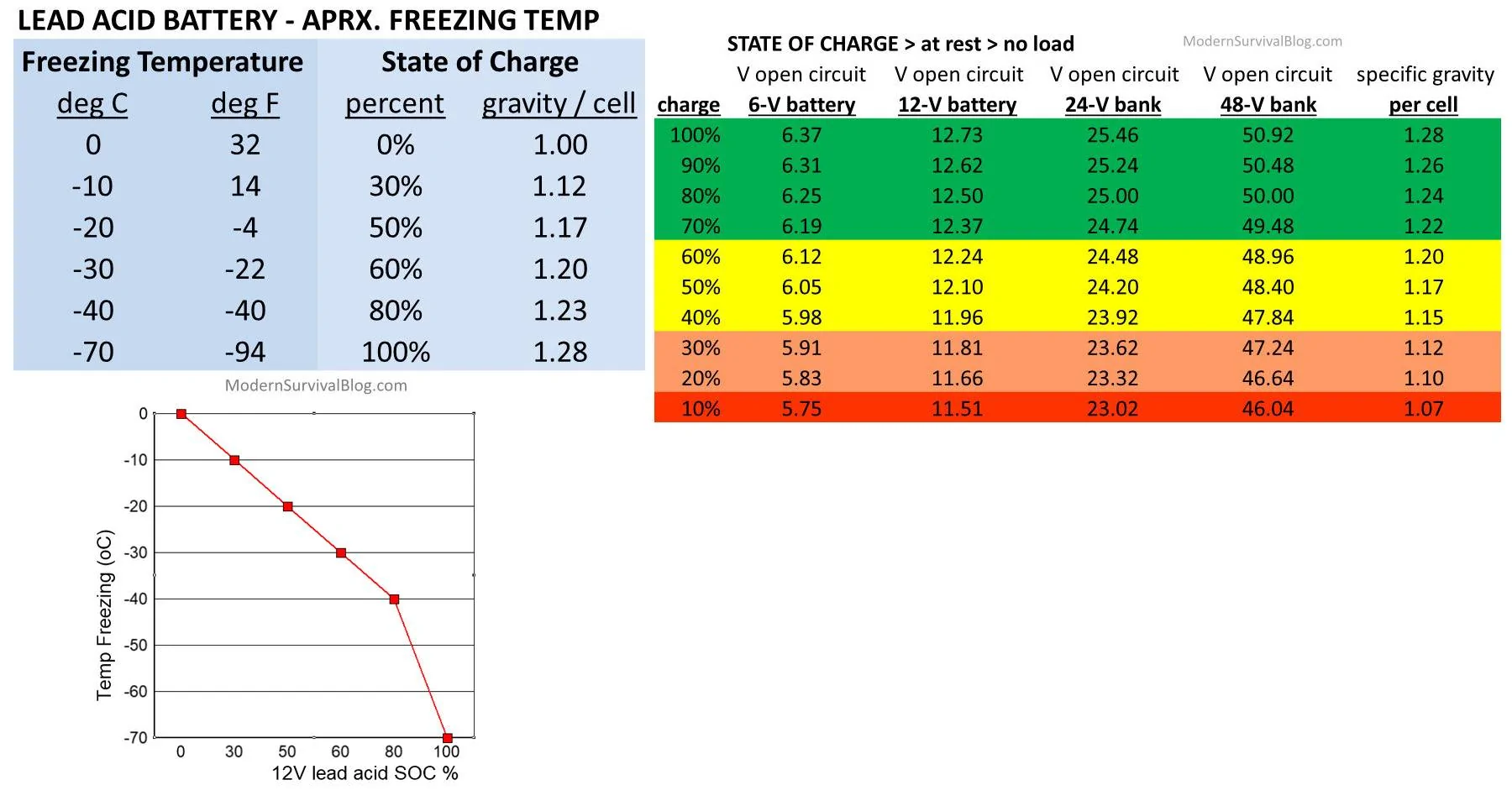

Not sure the diff between plate and glass mat with not a lot of info on AGM to date that I could find. But lead acid is pretty well documented. Throwing this out for those in the know is AGM really that much different or was 35% destined to cause problems? Appears going over 80% reaps rewards? Sitting at 55% in a cold night in Alaska.
Not one taker? Can not be too much difference the freezing point of sulfuric acid in an aqueous solution no mater what the container is. Normally once froze and the water expands the battery case deformation is permanent (the plastic case goes plastic ;) ). Battery is done just wondered if it would still take a charge once thawed out. I know cracked plates would normally not.
Antifreeze which is glycol and water at different concentration will freeze in the small heater hoses first as more surface area and less mass. There can be some differences with battery types agm to plate (there is on charge voltage) but both are water based so you would think not huge. At least they will not sulfate now at 55%. May go slushy in a lot of areas but no sulfation.
A charger can charge a number of different batteries but for the MME the charging logic is for one and only one battery? Take the one AGM battery and test it at different temps. Ford should have the budget to do that. We use math to model reality but reality does not change. I guess we will see if 55% is the minimum threshold. The first 2 appear not to be since we are seeing it change. Should be able to put covers over the 12V and it lasts forever in places where no extreme heat. Our poor 12V's.
