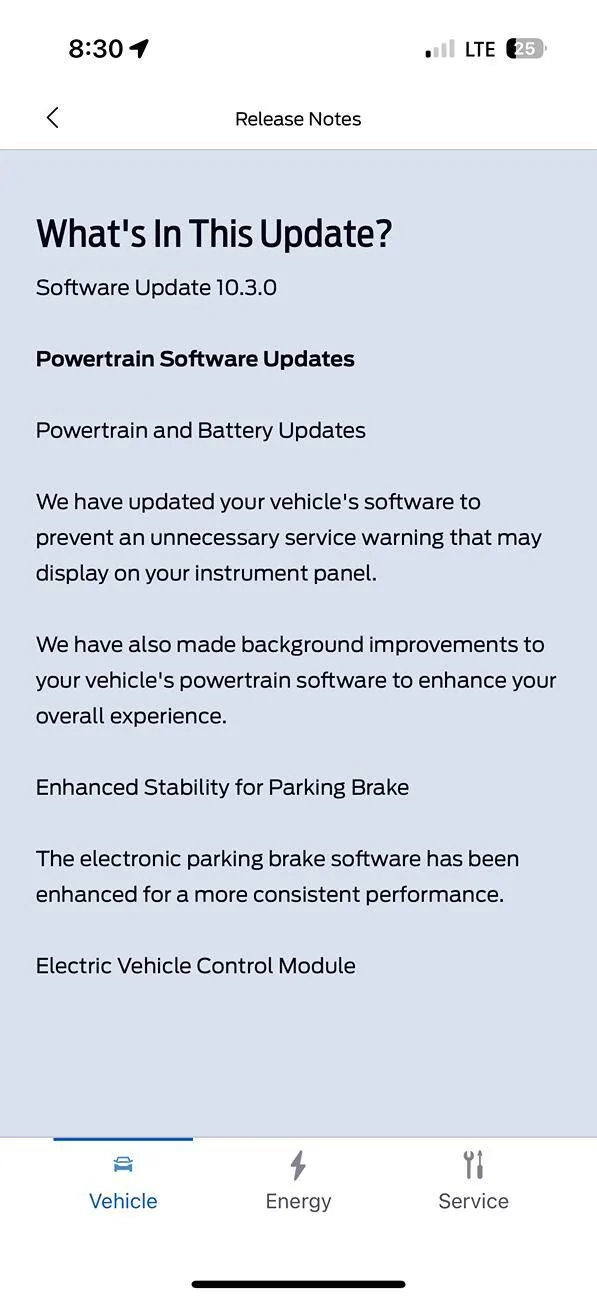

My Lightning just received 10.3.0 it might have been in here:
Ford Mustang Mach-E 12V Battery Recharge Threshold Improved in Latest BCM Software! IMG_1040

Here’s the sound the truck made while updating to 10.3.0. Sounded like a swarm of angry bees. This may be fairly normal, I usually don’t listen during updates.
@Mach-Lee is this normal?

That's the oil pump inside the drive unit. Normal for it to run during some updates. It's been a while since I updated a Lightning, I think there was some wavering to the pump sound IIRC but it might be worse because the oil is cold. If you have no codes then I wouldn't worry about it.

I've heard it do that on both the front drive unit (SOBDMB) and then the noise switches to the back when it's updating the rear motor (SOBDMC).
