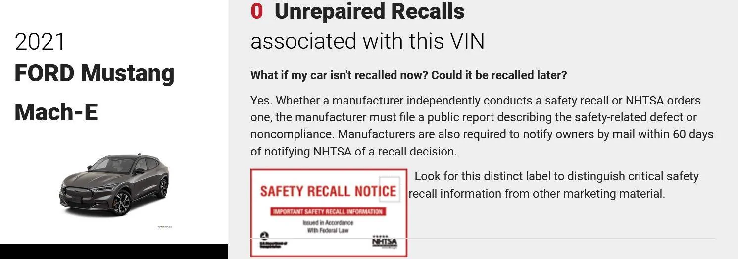

looks like no open recalls but the weird thing is the service records dont show that any work was done for recalls.. just misc maintenance and some trim replacement.
Is it a ‘21 Job2 car? It might not need any recalls for the glass roof. The software recall for the HVBJB probably got done OTA. Also probably missed the half shaft and CV joint issues. ??
