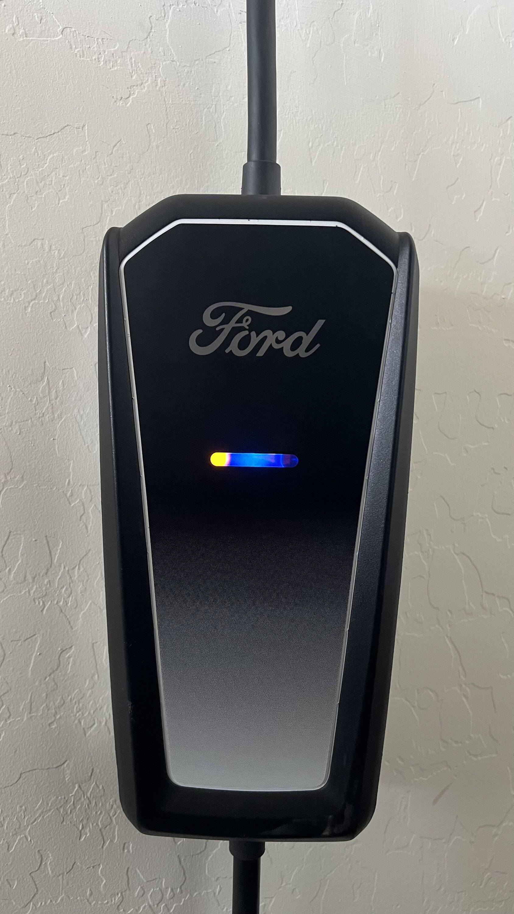

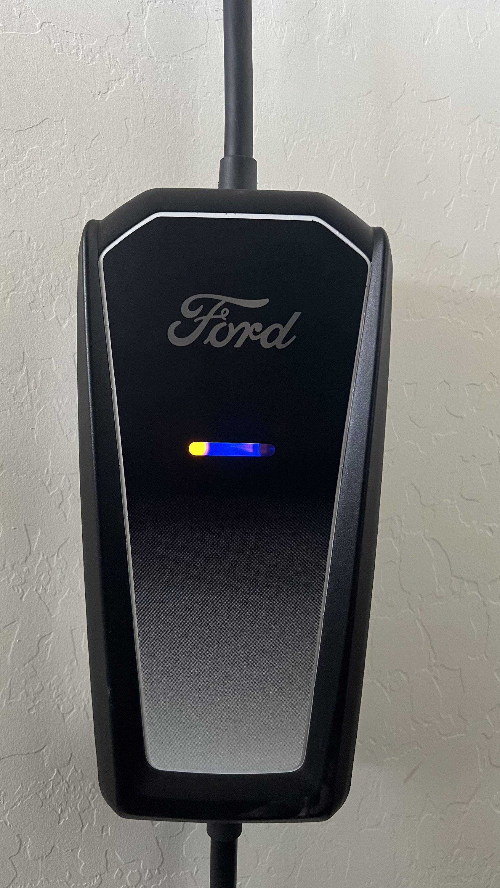

This is regarding the charger that came with the car. Original was already replaced due to amber light overheating. We are currently on our second charger and and we are still having issues and don’t know why. The first charger would give us an amber square in the corner, this 2 d one gives us the same amber square light but with a weird sorta arrow looking amber light as well in the middle. Looking at the app the charging time stop times change as the amber lights come on.
has anyone experienced this or have any suggestions on what it could be ?

How long have you been using the replacement charger? If it’s new and the amber light is on, you could have a bad outlet overheating.
When the amber light comes on, unplug the car, then unplug the charger from the wall and immediately feel the metal prongs. If they are burning hot you need a new outlet.
Replacement charger about 2 months before we started noticing the amber again. It’s a new build and outlet has already been replaced same time we replaced charger. Thanks for the prong advice, we’ll check that out next time.
Even though it turns amber I still get average 22 miles an hour.

It’s still the amber “Overtemp” indicator. I suspect the color aberration is just a funky display - no hidden meaning.
