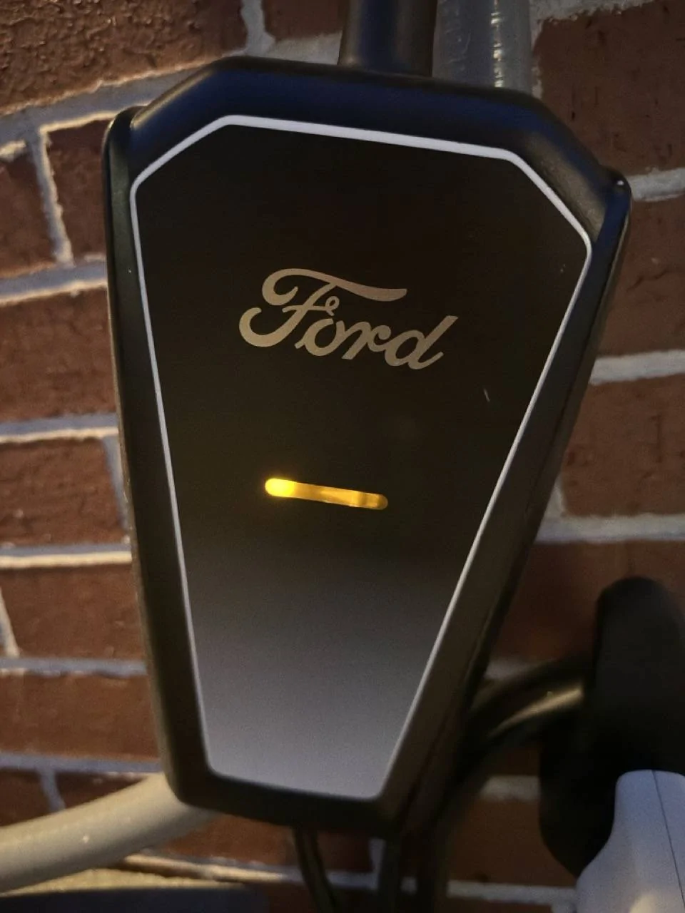

What does this mean?
seems to be charging just fine.. doesn’t feel hot…
Any clues?

So I was using mine fine at one house (first time using it), then drove it to my house and got amber. I’m just moving into this house and going to have electrical work done. I knew most of my outlets had no ground, even if there was a three prong outlet. Sure enough I got a tester, every outlet near my garage is ungrounded. I brought the mobile charger inside to a known grounded outlet and it worked!

Won’t the evse throw a GFCI error without a proper ground to monitor?
Any clues?
It means it’s on its way out. Replace under warranty if you can.

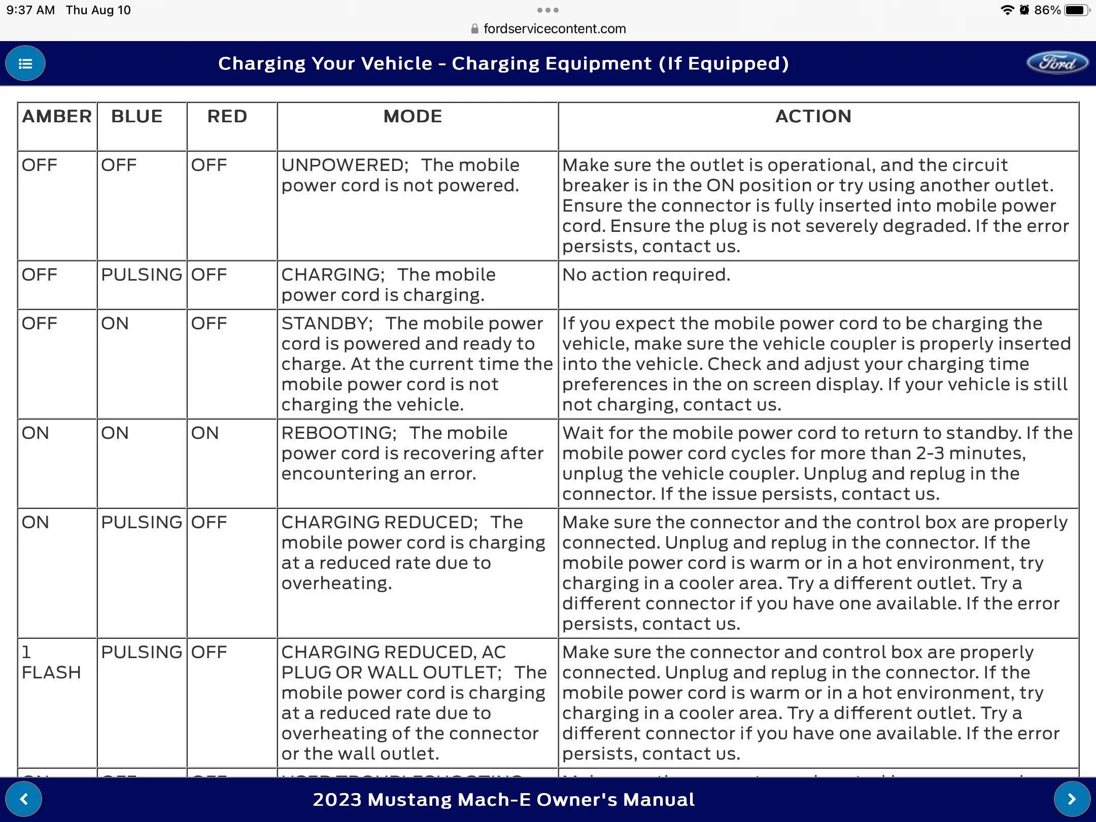

From your Manual.

Thanks. Nothing is flashing. No red.
Tom's Ford in NJ could not even check the charger because they don't have a 220 line for level 2. Who do i contact about getting it looked at.?

Call Ford, explain your problem, tell them to contact the dealer and tell them that it needs to be replaced. Some dealers suck. Mine replaced it without question.

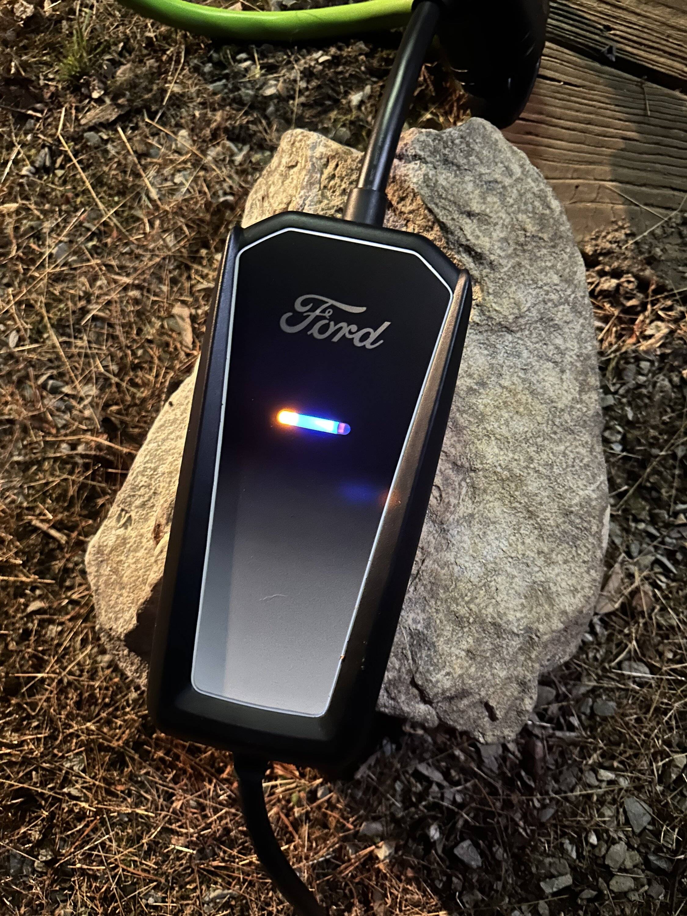

I got just solid Amber light but wasn’t even plugged into car. I unplugged and replugged into receptacle and went away. I suppose in order for dealership to replace the amber light will need to be on?

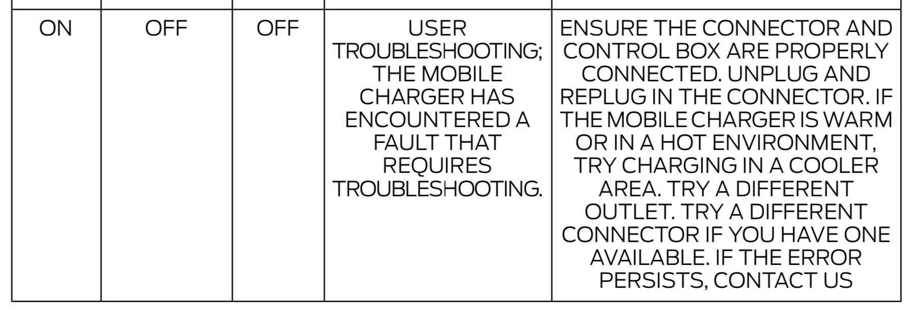

From the manual for amber light on solid (not flashing):
Does this happen all the time or every once and a while?
I get that light once every few months. If I unplug and replug it from the wall it goes away.
In my case, either the charger is warm or it’s likely just a generic fault (maybe a power surge or outage caused it).
But I haven’t replaced because it still works and chargers almost always.
