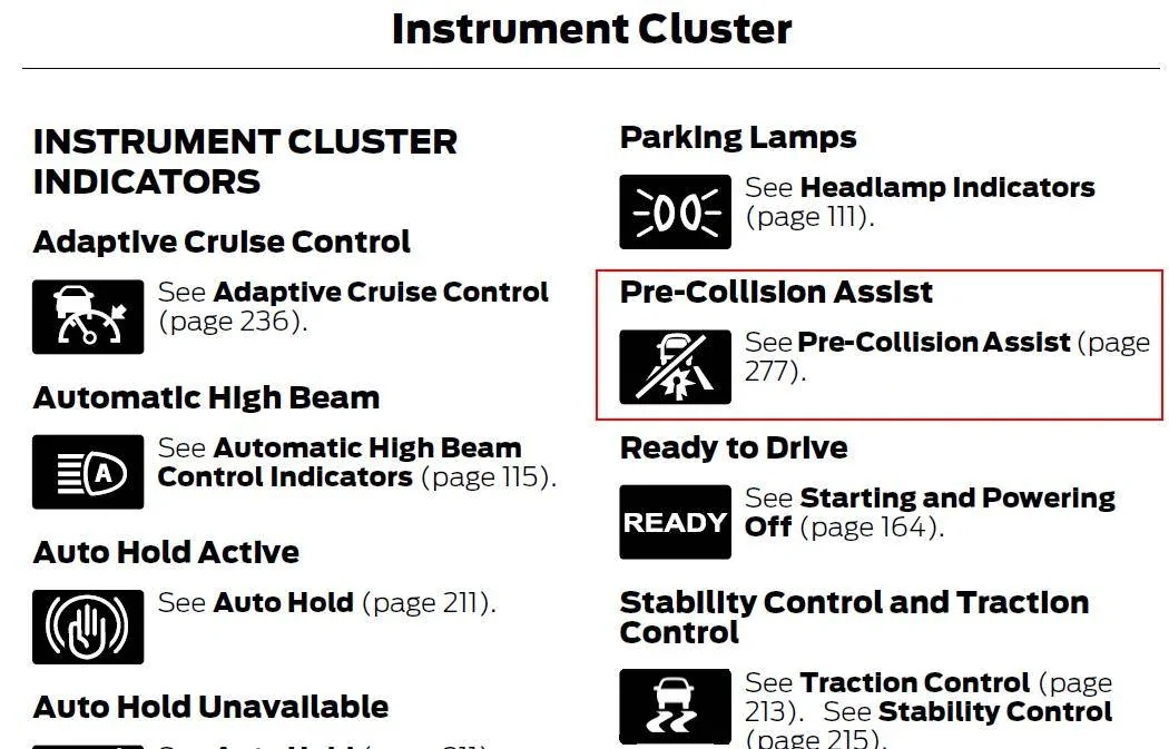

Every now and then I get this warning light. It is Orange and to the immediate left of the compass indicator on my driver dashboard.
I assume that the color implies it is something to be taken seriously, but I cannot find anything in the user manual that corresponds to this.
Can someone tell me what this means?

It means you car is warning you that it is not ready for any collisions you may be thinking of having. So be careful (and call your service advisor).

It means your front collision sensor has malfunctioned. You need to take that back in, possible recall issue.

The first thing to do is to clean your windshield by the rear view mirror, and make sure your front bumper (center area) is not plastered with mud or bugs. If the error still exists, then take it in to the dealer.

Crash avoidance front camera inoperative , comes at the same time I get fault message
