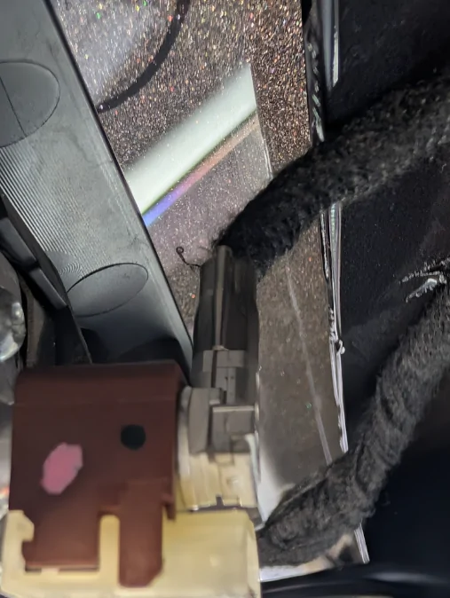

The coax going into the IPMA seems to be in good shape and solidly connected. I noticed again this morning that the dashcam's GPS didn't lock onto satellites until after I'd briefly shut off the Collision Avoidance & Lane-Centering functions. Whether there is a connection between the actions isn't clear as it may just be related to the time it takes to lock-on to some satellites. I'm going to go ahead and remount the dashcam, which was installed with 3M VHB adhesive, on the frit area and add a ferrite bead for noise reduction on the power cable as it goes into the dashcam. If possible, I will also reroute the dashcam's power and rear camera cables so they no longer pass through the housing above the rearview mirror.

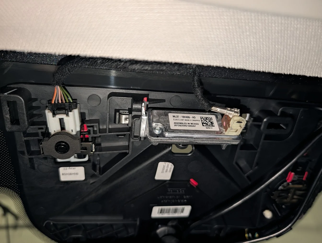

FYI the camera coax should be coming off the connector at about the 9-10 o'clock position, and should not have any sharp bends near the connector. Like this:
Ford Mustang Mach-E 2022 Mach-E Causing Dashcam GPS Interference Near Rearview Mirror? Comparison with 2025 1780761613517-f4
I would keep any dashcam wiring at least 6" away from that front camera.

The coax was coming out of the connector at a 12 o'clock position, which resulted in a tighter 90° bend than what you show. It didn't appear to be kinked or damaged in any way, but it did have a fairly sharp curve. I rotated the connector so it now looks much closer to your installation.
Interestingly, I may have stumbled onto something in the process. When I took the car out a little while ago, the dashcam locked onto enough satellites to calculate speed, position, and direction after about 2 miles and 4 minutes of driving. That actually seems pretty reasonable given that it likely didn't have current ephemeris data. Lane-centering and collision avoidance were both enabled during the drive, unlike an earlier test where it appeared that temporarily disabling them allowed the GPS receiver to acquire a lock. At this point I'm not sure whether the connector repositioning helped, whether the receiver simply had enough time to acquire satellites on its own, or whether it was just coincidence. More to come.
