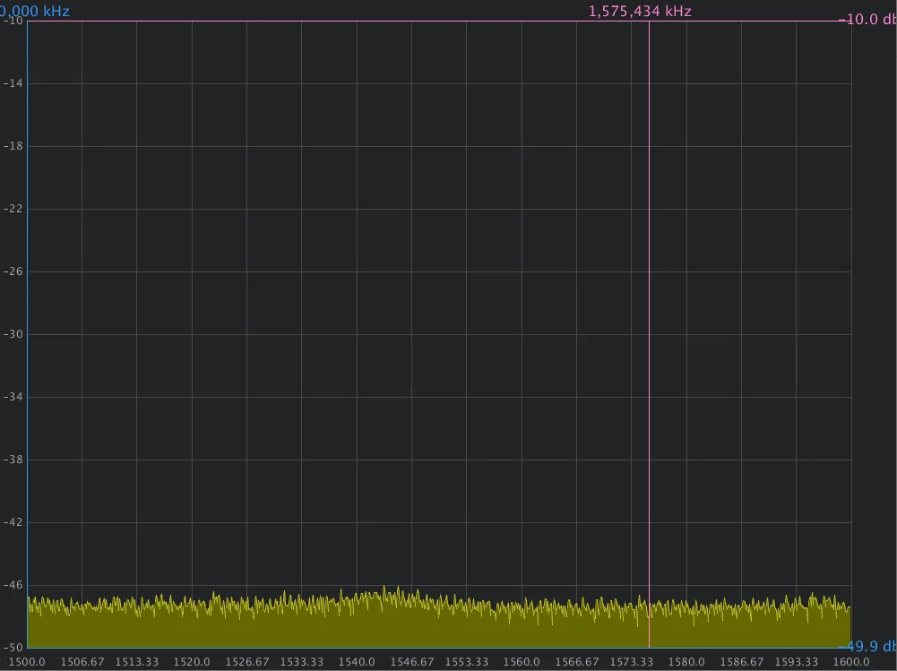

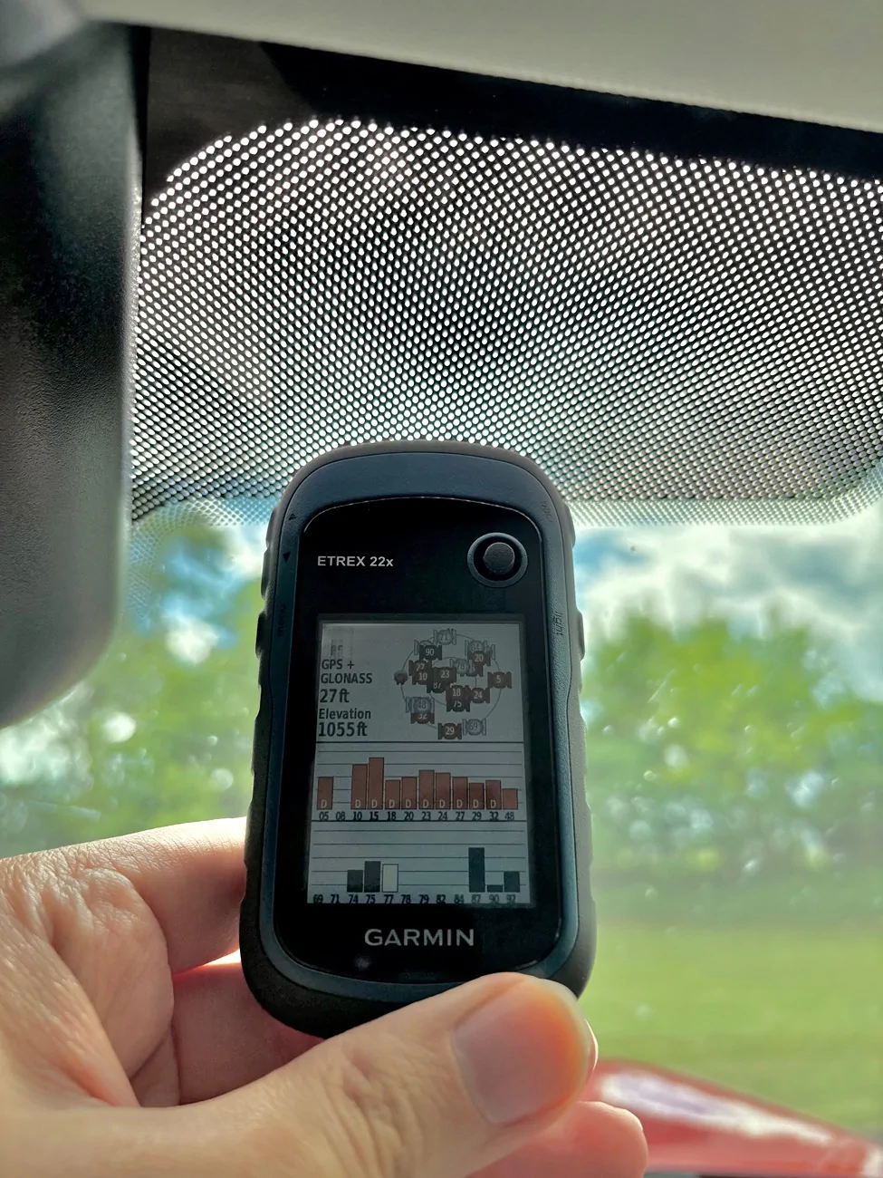

I decided to take a look at this. The area to the right of the rear mirror has only a small amount of interference in the GPS L1 band. My eTrex has no trouble getting a GPS lock there. GLONASS had a lot more trouble, but they are weaker satellites. The shaded area is where you want to have the GPS antenna attached on an IRR windshield.
Ford Mustang Mach-E 2022 Mach-E Causing Dashcam GPS Interference Near Rearview Mirror? Comparison with 2025 IMG_2184
Right side windshield:
Ford Mustang Mach-E 2022 Mach-E Causing Dashcam GPS Interference Near Rearview Mirror? Comparison with 2025 Baselin

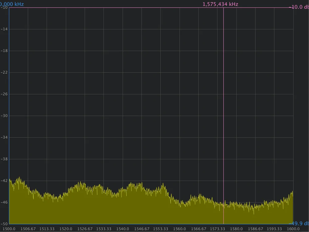

Scanning around, I could only detect significant interference near the IPMA front camera coax connection, which makes sense since that is a signal cable. The area is located above the rear mirror very close to the interior temperature sensor. The interference was very localized, within only about a foot. However, I'd image there could be much more signal leakage and interference on a vehicle where the IPMA coax connection was not fully seated or if the coax cable was damaged. As some of you know, the IPMA front camera coax cable and connection is delicate and is frequently damaged by windshield replacement technicians.
IPMA coax connection:
Ford Mustang Mach-E 2022 Mach-E Causing Dashcam GPS Interference Near Rearview Mirror? Comparison with 2025 IPMA camera
I also confirmed the IPMA interference is directly tied to the ignition status, the camera is active in ON and ACC modes but the signal cuts as soon as the ignition is turned OFF.
So if you are seeing a huge GPS interference and you're ruled out every single aftermarket item on the car (including disconnecting dashcam power supplies, which can be a significant source of interference), I would say double check your front camera coax cable connection, or have the coax cable replaced if it's damaged (which can also cause ADAS faults).

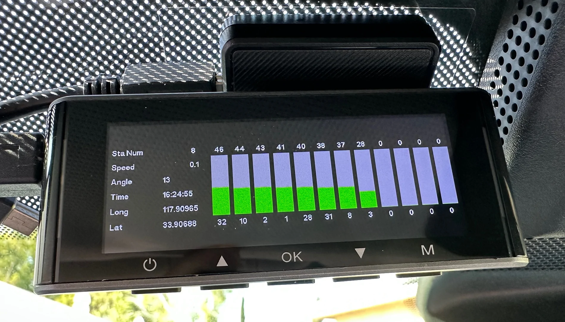

Talk about a brain fart. After Lee posted, I remembered that that my Dashcam had GPS. I have a no-name unit and it is mounted right where Lee was measuring.
Mine is 5.5 years old and this is what it can grab. It is facing north, but there is no objects to block the signal. It also took 30-40 seconds to acquire Keep in mind this is mounted on the ceramic tint and there is a cheap screen protector on the tint and the antenna is mounted to the screen protector I did this so I could easily remove it when this thing died
Ford Mustang Mach-E 2022 Mach-E Causing Dashcam GPS Interference Near Rearview Mirror? Comparison with 2025 IMG_5478

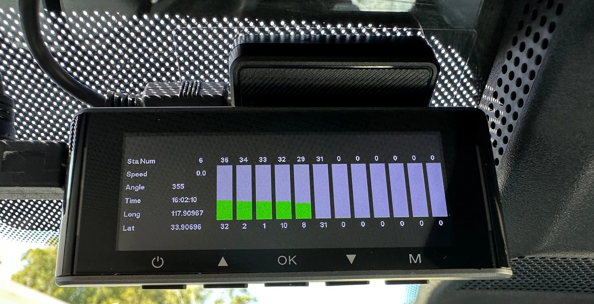

Then I went searching for a mini-usb cable (that took a while) and powered up with a power bank and the car off. Picked up 3 more satellites but overall the signals are still weak.
Ford Mustang Mach-E 2022 Mach-E Causing Dashcam GPS Interference Near Rearview Mirror? Comparison with 2025 IMG_5479
So there is interference, but you should get something. Or better satellites came into range.
