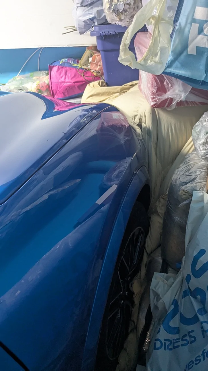

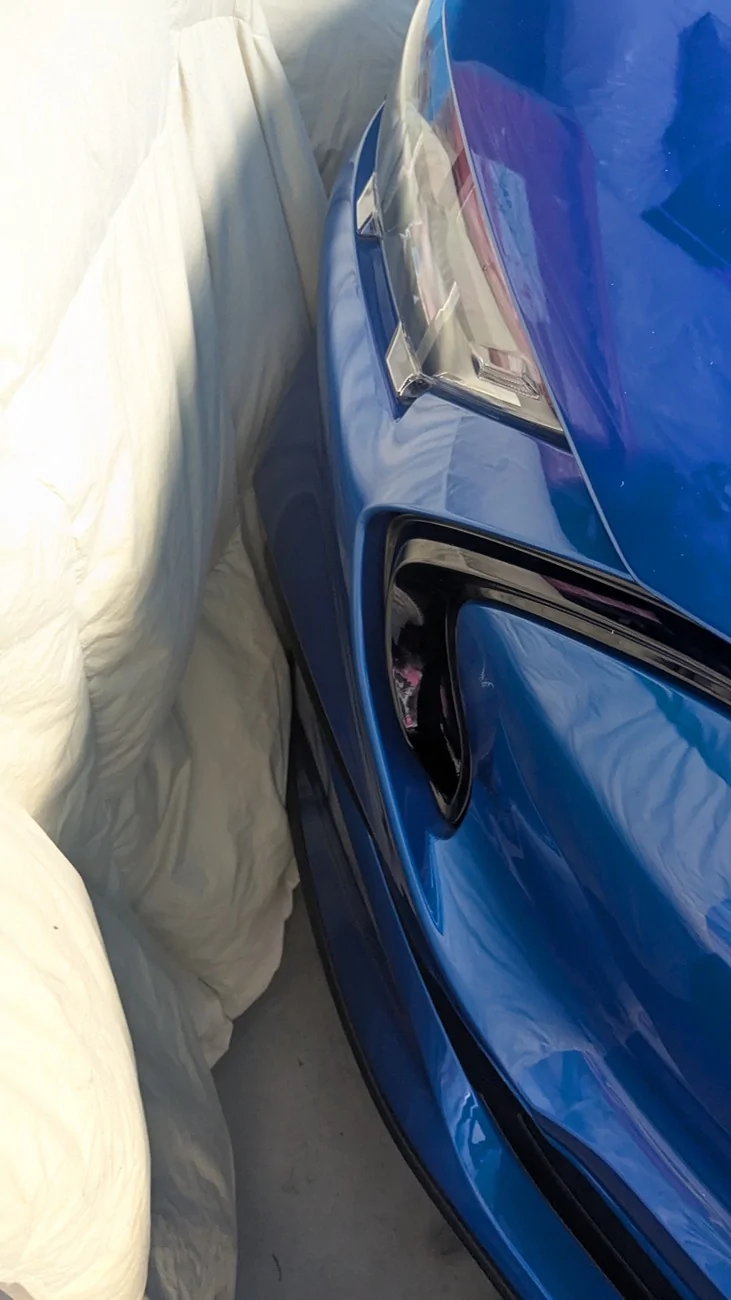

I got curious enough to create a fake wall. Note I have a 2025.
This is how close I got (I pulled down the "wall" in the process):
Ford Mustang Mach-E 2022 Mach-E Parking Distance Sensor Issue PXL_20250920_003906433
Ford Mustang Mach-E 2022 Mach-E Parking Distance Sensor Issue PXL_20250920_004345066
Different test:
Ford Mustang Mach-E 2022 Mach-E Parking Distance Sensor Issue PXL_20250920_005025169
You will notice that it shows the sensor "black". At no time did I get that warning message.

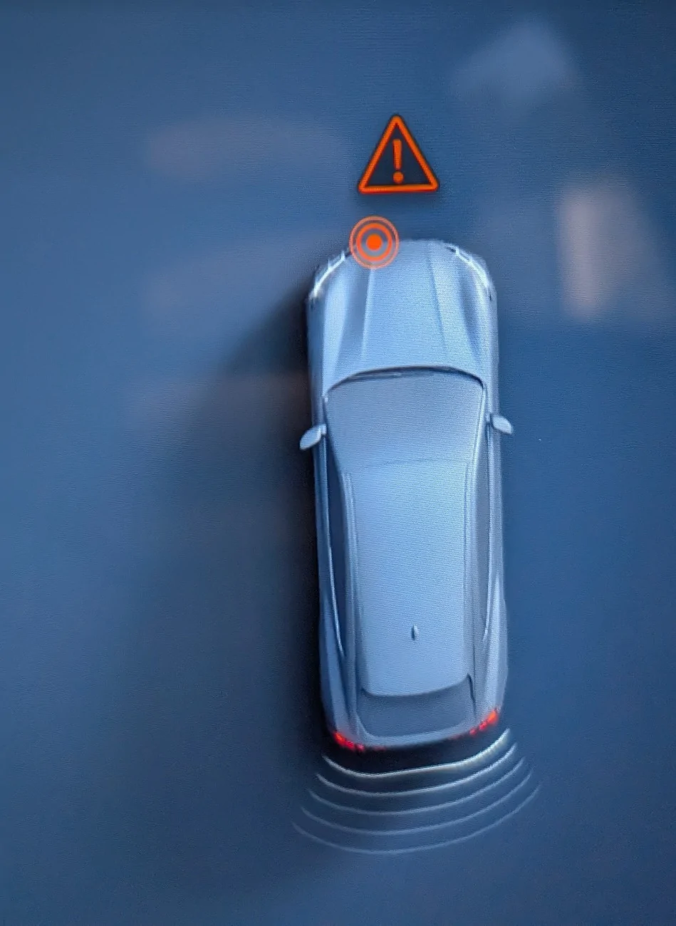

I have this alert popup when I start the car, and when I stop in traffic. Surprisingly I think it even shows which exact sensor has the problem (see photo). I'm assuming it's faulty since that sensor is never blocked when the alert goes off. I'm hoping if the sensor was just disconnected and I could reconnect it, then I'd get a different alert. So much for no trips to the dealer during my entire lease.
