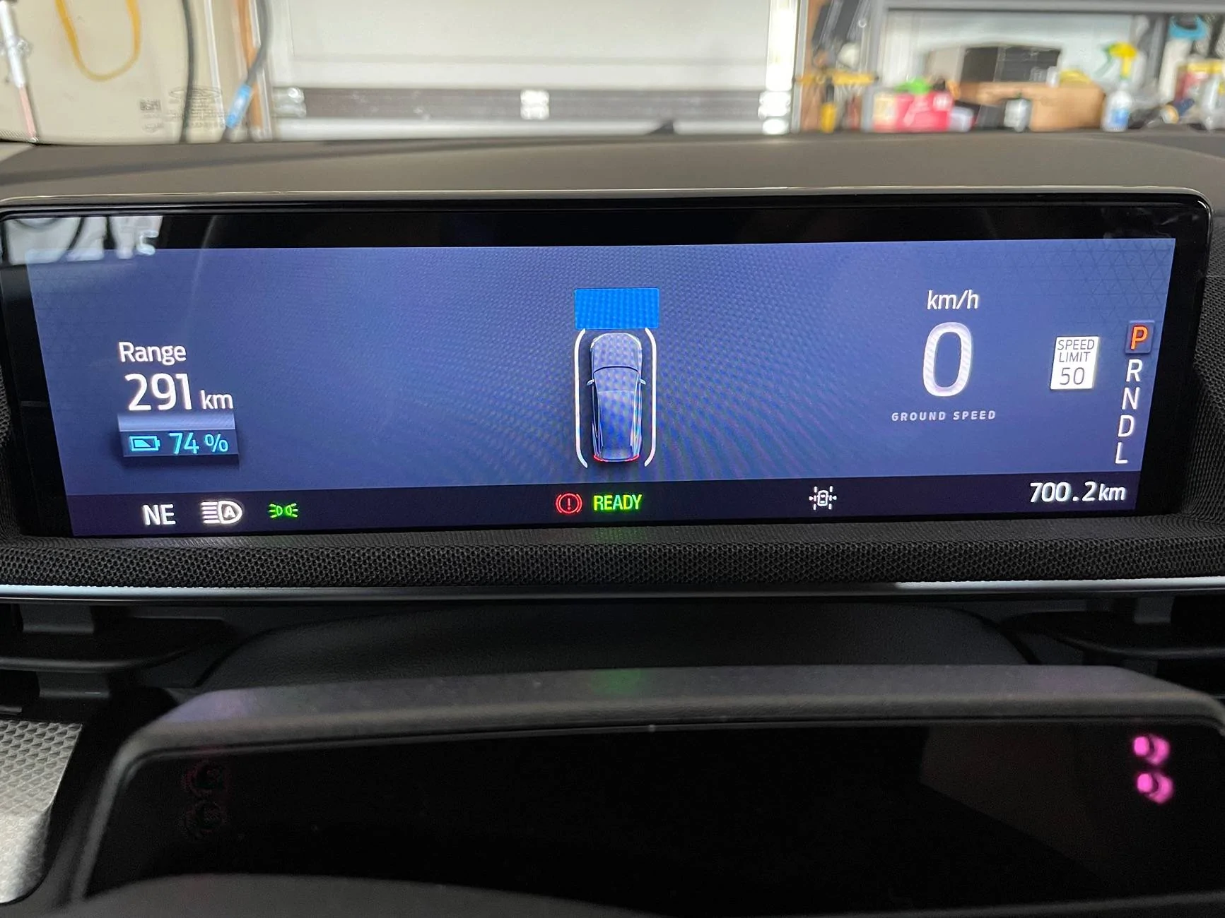

So I got 6.1–6.3 in the past 2 days. I lost blue cruise and regular adaptive cruise with all driver assists. I also got this strange blue rectangle on my instrument cluster. I hope more updates are coming?
Did you, by chance, happen to recall getting 6.13 (even if out of order)?
There is a reported delayed bug with 6.13 that disabled the driver facing camera. This would result in lane centering no longer working as well as BlueCruise hands-free no longer working (both require driver monitoring camera to work).
There was an attempt to fix this via OTA and I’m not sure what happened with that. I was told to take my car to a dealer and they would manually install the fix. The dealer got the car in the morning and I had the car back later that day … with BC and lane-centering working once again.

A bunch came in but it appears they came in order from 6.1 to 6.3 as the latest from what I can remember
So… THREE things:
1) Depending on when you bought the car and what model year you have … has your BC subscription expired?
2) I had an issue with my ā€˜23 (I also have a ā€˜21) where BC wouldn’t work because the maps were too old.
If this happens the car wont let you use BC because it doesn’t trust the maps. In my case, depriving the car of 12v power for about 10 minutes … and then reconnecting … fixed the problem. WARNING: If you do this … numerous modules have to reboot from scratch (instead of just waking from sleep). It will take a good 20 minutes to complete this and you WILL get error messages (don’t panic). Once that is done and you start the car (so now it’s been around 30 minutes), the car still need another … roughly 15 minutes to talk to the cloud, download map updates, etc. and then BC started working for me.
3) Apart from that incident … there was the bug that was posted here on the forum. The bug was such that once you got 6.13 … it was just a matter of time before the bug might trigger. It could be a day, a week … or several months. The bug was blamed on 6.13. I have no special knowledge of this … I’m just going by what others report. But this bug reportedly disabled lane-centering and BC. It requires a software update to fix. I read reports that there was an effort to send this via an OTA. I had to take my car to a dealer for the update. But it did successfully fix the issue.
