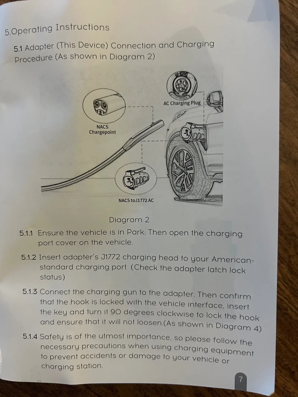

My new A2Z NACS to J1772 adapter arrived the other day. I’m looking forward to using it to recharge our 2025 Mach Premium on my daughter’s level 2 Tesla charging station at her home in NJ on our next visit. I read carefully through the A2Z operating instructions and it says to first “insert adapter’s J1772 head to your American Standard charging port” then “connect the charging gun to the adapter” Some new terminology there to me. My interpretation is I plug the A2Z adapter into my Mach E port first then connect my daughter’s Tesla connector to the adapter and hopefully there is some handshake and it starts charging. Sounds easy and hopes it works but curious why the connection order is opposite what I’m told should be done when using my Ford supplied level 3 adapter at Tesla superchargers. There I’m told to first put the adapter on the Tesla “gun” before plugging it into my Mach E port. Makes me wonder if the order of connection matters at all on the A2Z adapter. Any insights?

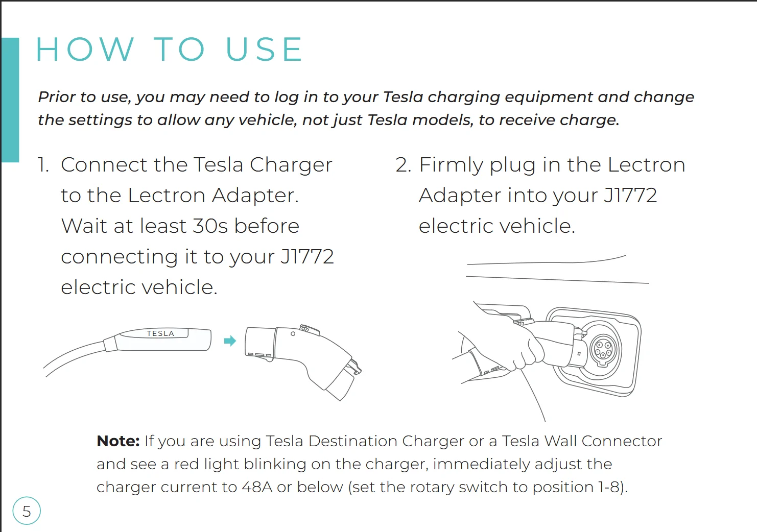

That's what Lectron says as well - Adapter to Charger 1st, then to the Vehicle...

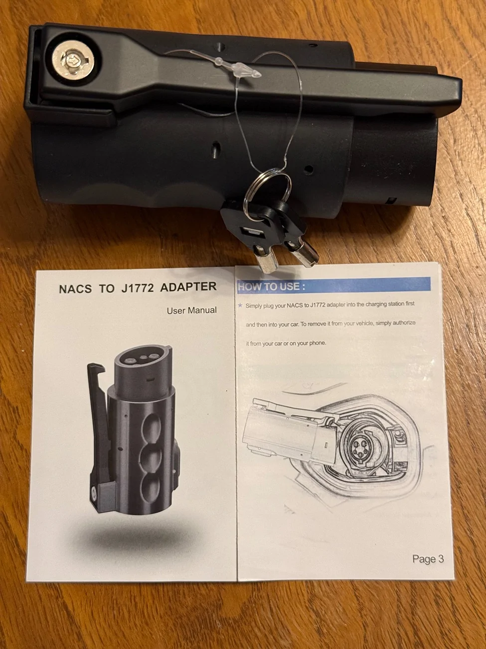

Thanks for the replies. The A2Z instructions that came with my adapter show the opposite procedure as per attached. I will though go with the collective wisdom of this group and and start by connecting the adapter to my daughter’s Tesla plug.

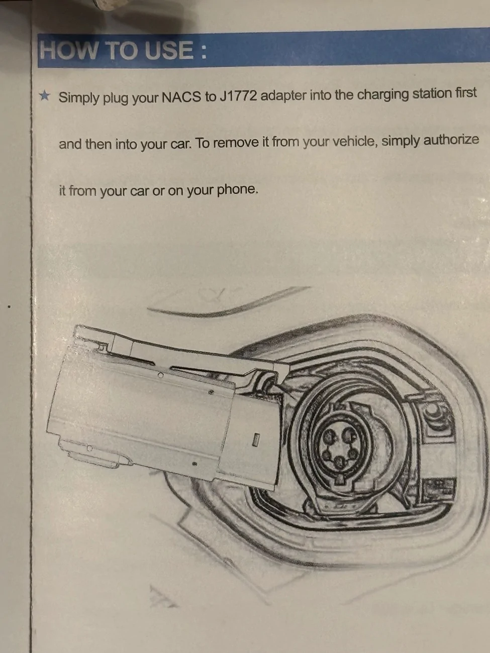

My A2Z adapter instructions say attach to the Tesla cord first and then plug the adapter into the car. I too have the Tesla Universal Connector with its own adapter and it obviously is plugged directly into the car. I say obviously because the Tesla adapter cannot be removed by hand, only left in the EVSE.

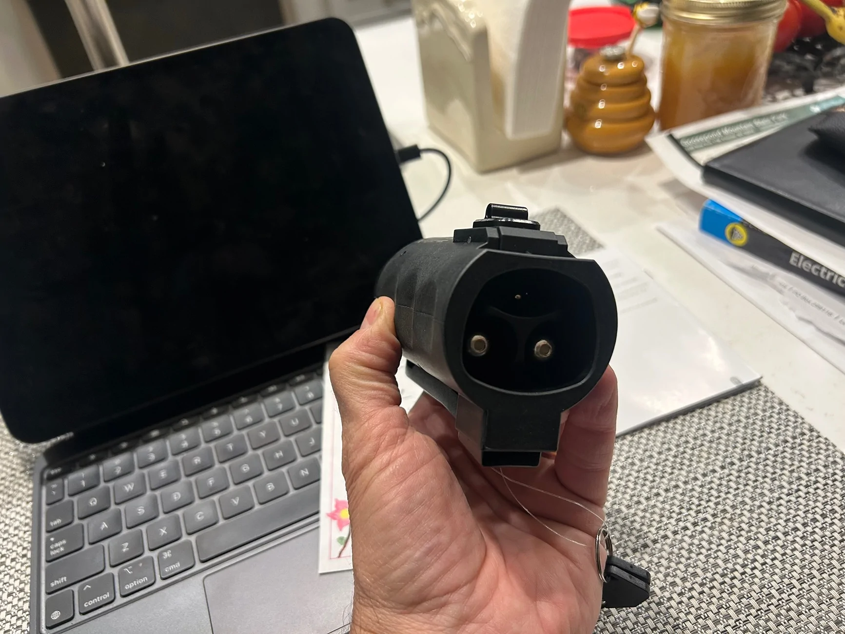

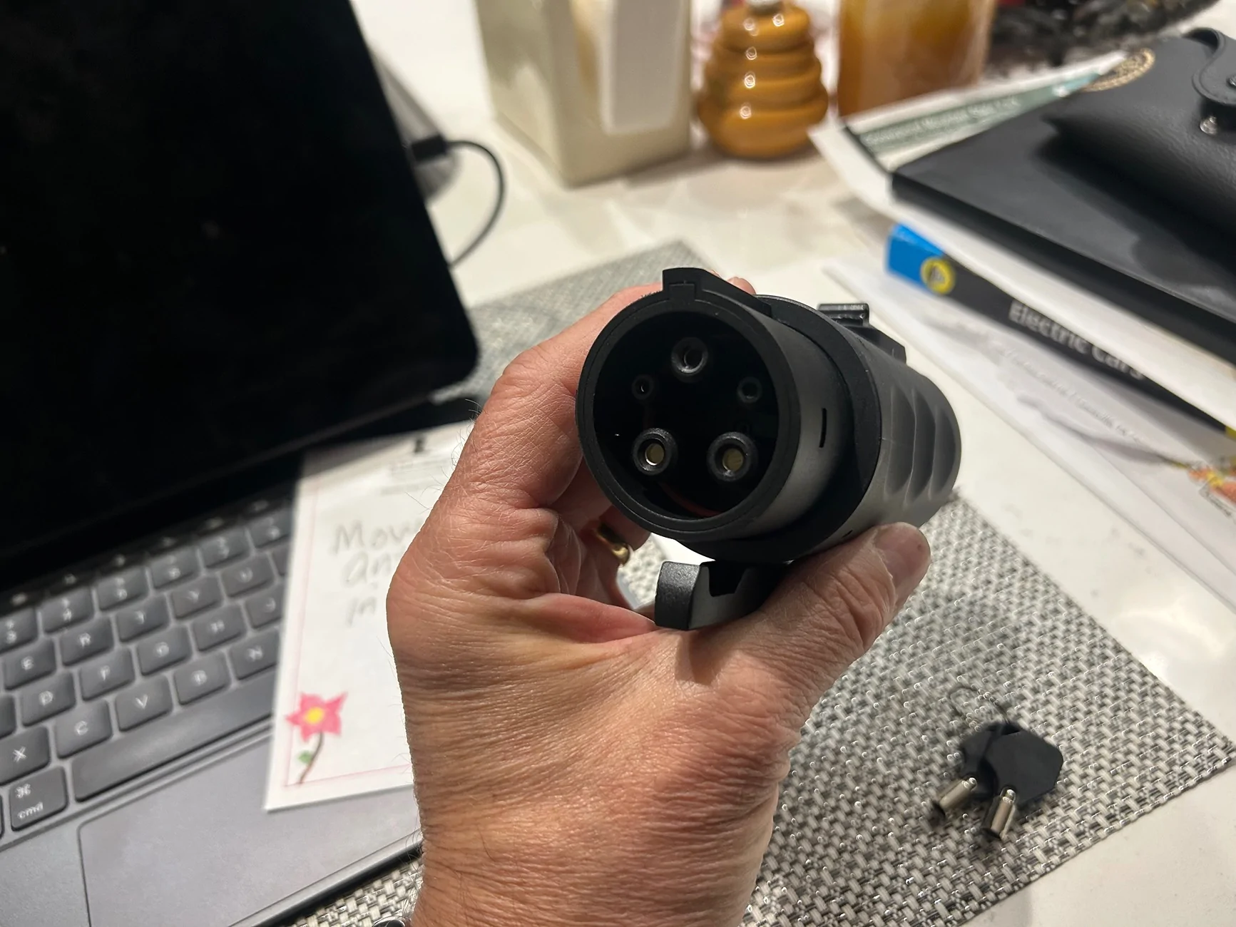

Strange the same adapter would have different instructions. Hope I got the right one! Item # 628942279492NACS, Charger To J1772 Vehicle | AC | UL2252/CSA-C22.2 Certified | The Stellar Plug1 Here is what it looks like.
