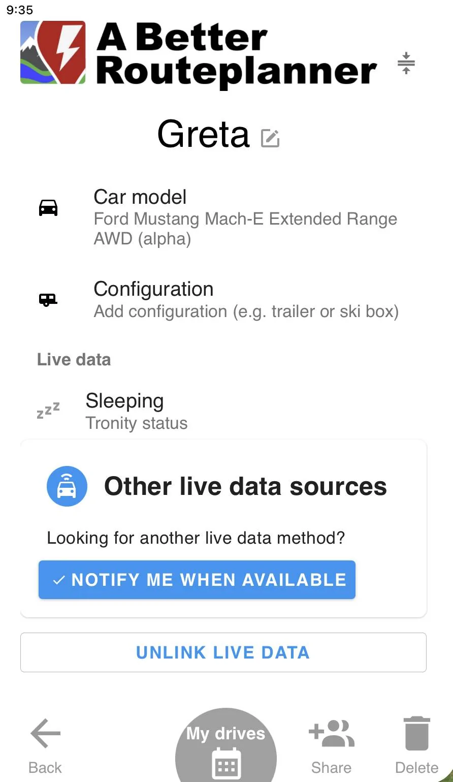

I'm trying to connect my MachE to the ABRP+TRONITY combo but the MachE are not supported by default in ABRP. Anyone got it working with the manual config?
I like the way TRONITY get the car info by API and not via ODB or other hardware so to get that info in ABRP would be great. The down side is that a subscription is needed (using the 14 days trial at the moment).

I upgraded ABRP to the Premium service and was able to integrate TRONITY into it. You need to setup TRONITY with your Mach-E and then in the ABRP Settings, Car Model, select your Mach-E and you should see an option to add TRONITY as a data source.
The ABRP app doesn’t update to show a live link after the setup so back out of the settings and then return to see if it worked.
Just did this today so haven’t had a chance to test out ABRP with the TRONITY integration.
