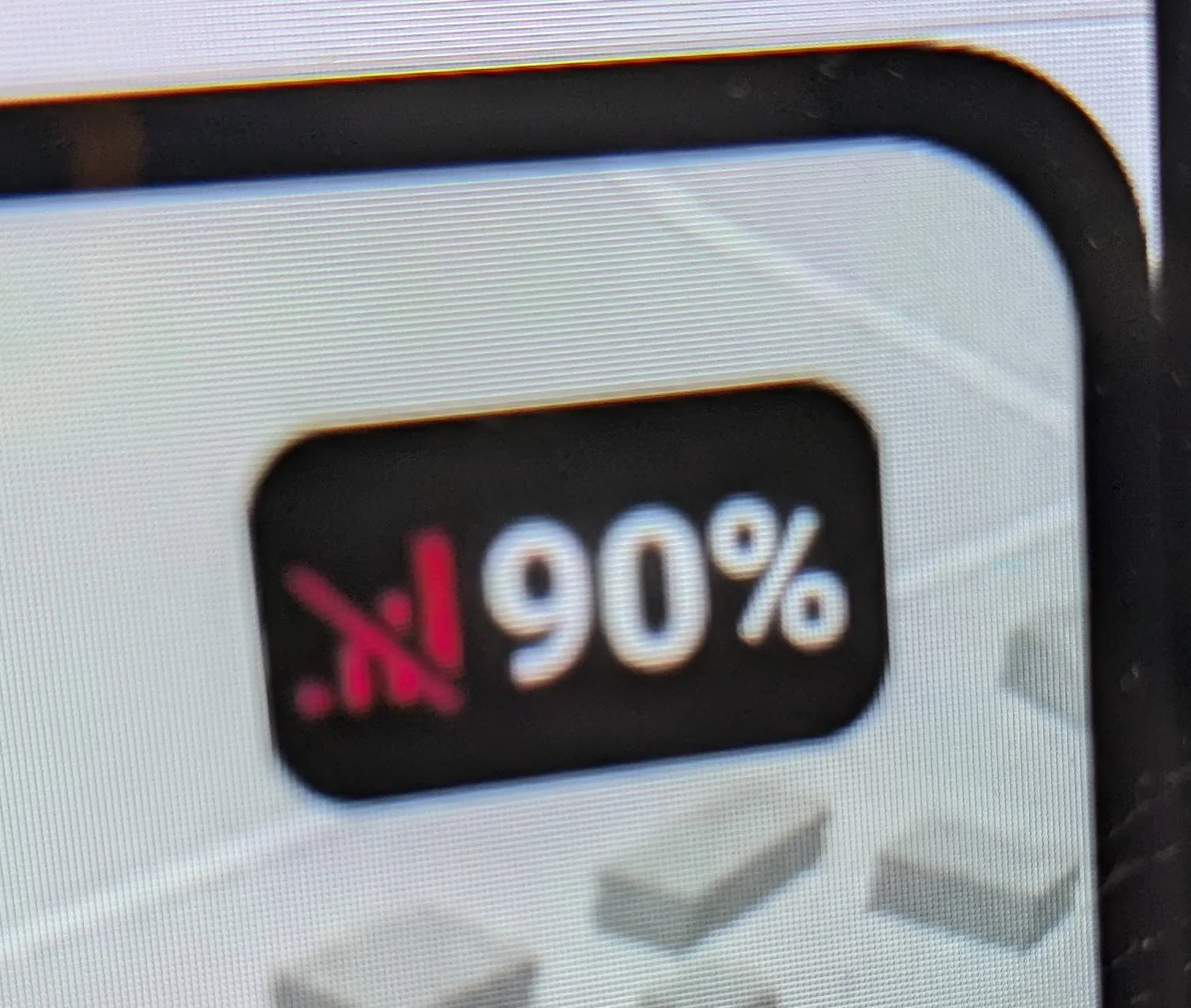

Today ABRP started getting the SoC data from Android Auto. It looks like it may have stared working after I updated AA to v14.3. I tried it on the way home from work and it worked great.

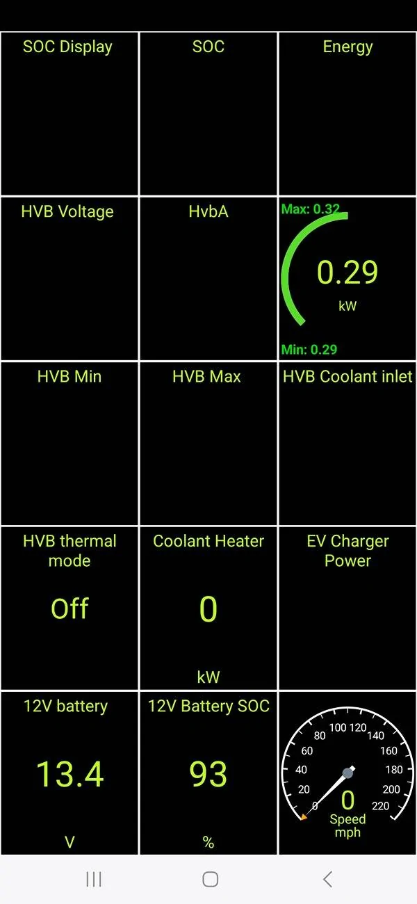

I just picked up my 2025 Rally today, and my OBDLink CX is no longer getting SoC, so I'm dead in the water as far as ABRP is concerned. The OBDLink CX is on the newest firmware, and communications is working, but it simply won't get the data.

FORScan light has the PID's for 2025 now. I have been in talks with ABRP support. They asked if I can get the logs from FORScan with the PIDS but have no clue how to do it.

Are you Android or iPhone? ABRP will grab the data through Android Auto without an OBD dongle on the 2025's according to OP @BOB4X . You need the ABRP subscription to get the AA data integration on the car screen.
