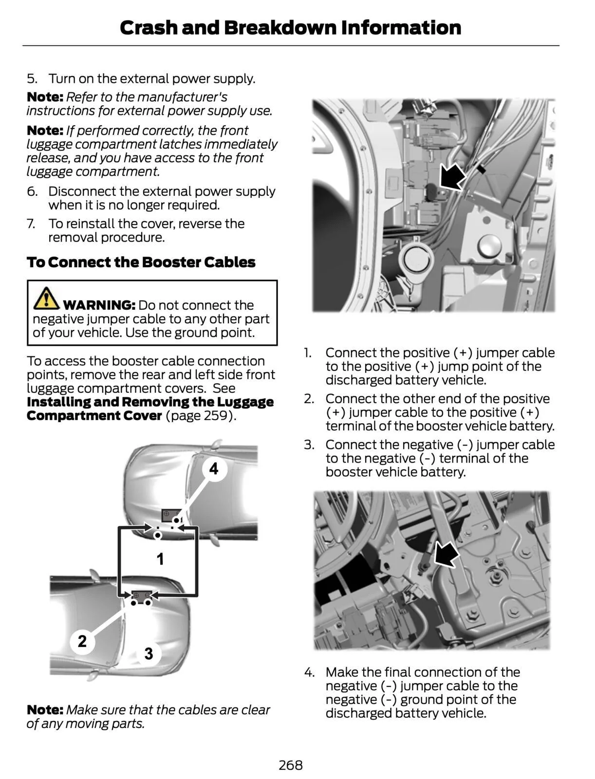

I have a related question. Does anybody know if there is a specific type of connector that is supposed to attach to that remote positive terminal on the fuse box? You know...the terminal that the positive jumper cable is supposed to attach to?
I'm looking for a connector that I can permanently attach to run to cable for remote battery terminals that will let me put a charger/powersupply on the 12V battery while doing updates using FDRS,...without having to take all the covers off the left front side to access that area.
The shape of that positive terminal on the fuse box gives me the impression that a specific cable connector could have been made to fit it. But I can't find anything that looks like it would work.
