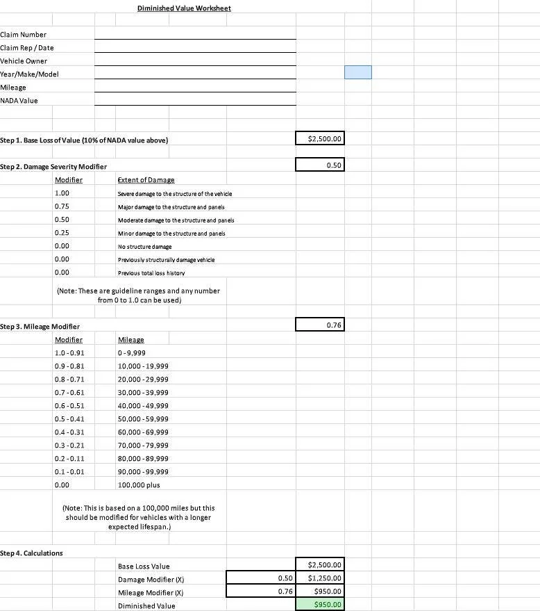

Plug in NADA value, take 10% of that, then apply multipliers (modifiers) to get what an insurance company is likely to use by default.
This is what USAA used here in Florida. 2018 Platinum F150. It was 7,000 miles at the time of accident. Trucks are a bit different only because dealers have few used. They had the pics of the accident damage and the buyer didn't mind. My damage repair cost was $11,700. No court needed.
FYI and for anyone watching this thread. Your truck had a significant amount of damage but what is critical in diminished value assessments is whether structural damage or air bag deployment occurred. USAA used a Rule 17C formula which severely limits DV payouts. The actual, real-world breakdown for your DV claim should have shown that, without structural or air bags, it lost 10%+ of its pre-accident trade-in value. If either of those two things occurred, it doesn't matter that trucks are scarce, any dealer will practically chop your trade-in offer in half. Ask any of them. Your DV should be appx. 35% of the pre-accident value.
