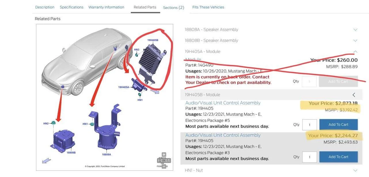

If you look at pictures of 2022 ME's you will see the sensors are installed. It looks like the $260 module in the image below is on backorder. It looks like it is plugged into a harness behind a panel in the trunk area. You could possibly get a junk yard part or purchase when they are available at a later date.
Ford Mustang Mach-E Active Park Assist powers side sensing 1665453310763
264
11,492
25,431
What you have circled is the IPMA, all Mach-E's will have one of those installed since it is used for lane assist and/or BlueCruise.
