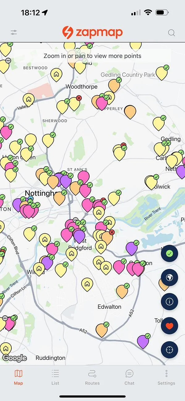

Yeah, well, ?you Elon, screw up all out kids with your social media shite but the UK don’t need your chargers or adapters, we’re sufficiently well covered and improving all the time, got one in my garage and the local area attached is typical of most of UK.
Ford Mustang Mach-E Adapter for using Tesla Superchargers IMG_7492
