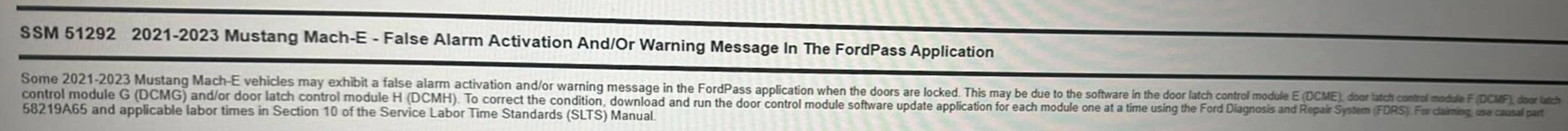

The fix for the door alarms going off is to update the door modules, not replace the TCU. I think your dealer is on the wrong track. This SSM just came out the other day, tell your dealer:
SSM 51292 - False Alarm Activation

I appreciate the tip, just curious…Who gave you this update?
If the Ford agent here isn’t offering any useful info, and the dealerships aren’t aware of how to solve the issue, I’m wondering who is providing this information or how they got it. I imagine dealership might ask me where this info came from as well.
Glad I’m on the forum and got this before I go to dealership on Monday. Thanks!

Thank you Anthony and Lee! My dealership is working on this as we speak, fingers crossed this does the trick.
Robert, the Ford rep on here is on their social media team so getting into the engineering details is not something they'd do. For what it's worth, my dealership didn't care where I got the info. If you just tell them to use/check SSM 51292 as the solution they will see it on their end from an official Ford channel. It just came out on the 11th, my dealership service department said they hadn't seen it yet but started the software patch as soon as they checked.

I just got this update this morning. I was instructed to go to my dealer and tell them I need SSM 51292 performed.
