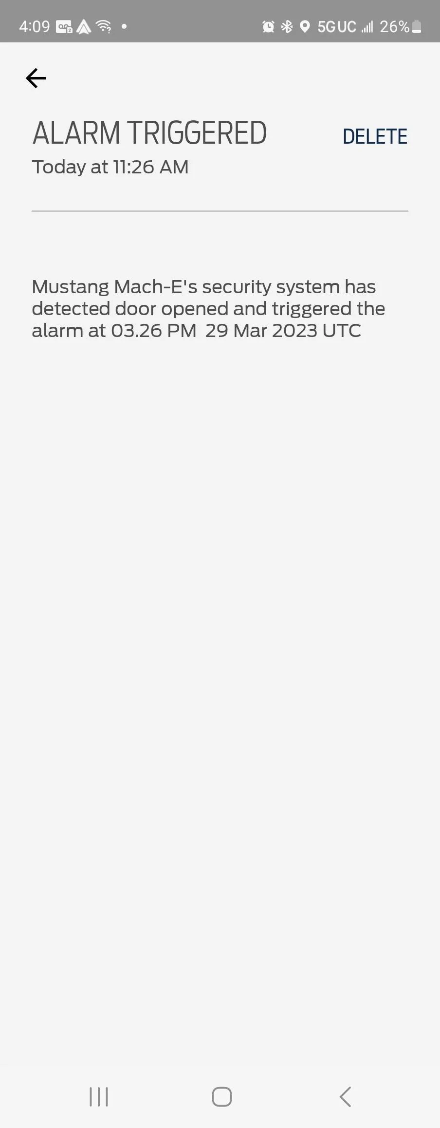

I also received , alarm triggered because open.door I was so stressed Because I received the alert at 11am. I was at work and don't get out till 4 hours from the alert.
Ford Mustang Mach-E Alarm going off - Detected door opened message Screenshot_20230329_160936_FordPass
