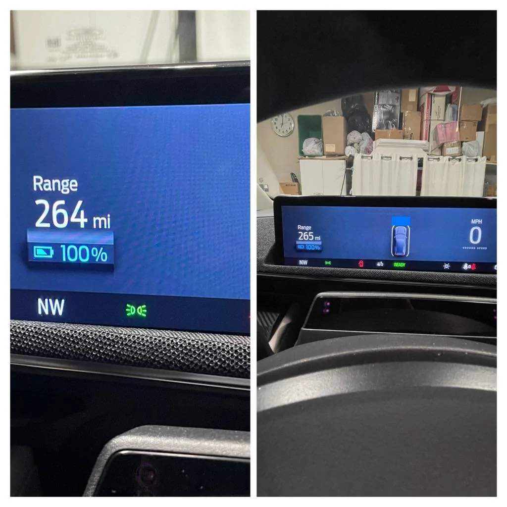

My Premium trim RWD 68kWh Mach-E worked flawlessly since i got her in May till now (7,800 miles), when it started to flash a "Pre Collision Not Available" warning. Took to dealer and they performed: TSB 21-2245, EEC test DTCS P1A10, U0293 in multiple modules, perform TSB 21-2245, re-program SOBDM, BECM, SOBDMB, PCM & ABS modules. Did road test and all functions working now. All faults cleared.
The Intelligent cruise control is back working, but now I have these nagging issues:
- Deep Sleep Mode warning is now constantly flashing, whenever I am parking w/EV on;
- my range decrease from 261-265 miles to 190 miles @ 100% SOC;
- have to fumble with EA dcFast charger, it is now showing me error at first plug in attempt. This is for both personal EA account or with Plug&Charge feature activated. This never happened to me before.
- unable to read no more than 19 music files from USB flash drive (USB 2.0 /FAT32) which previously I was able to read all 50+ files.
