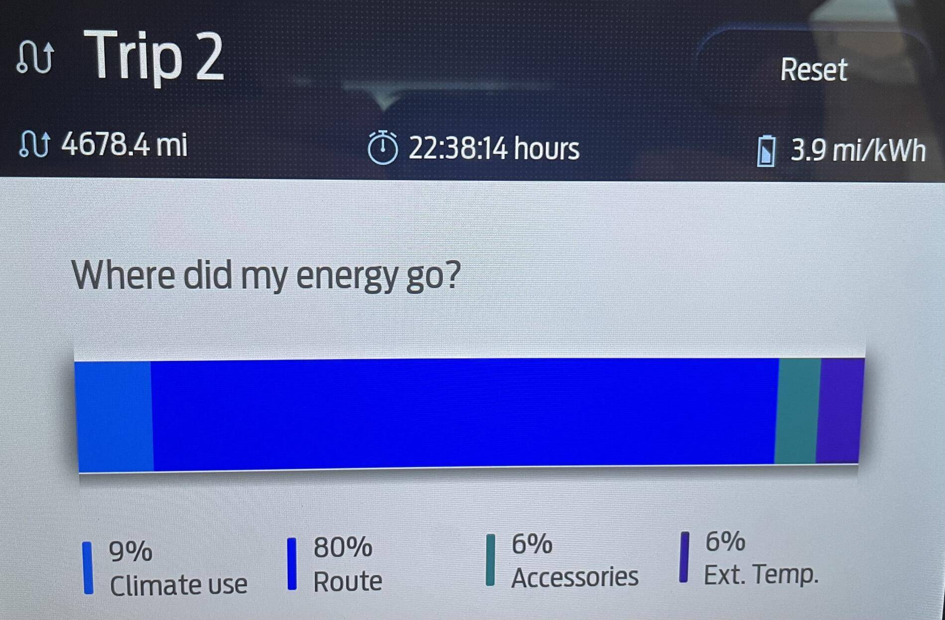

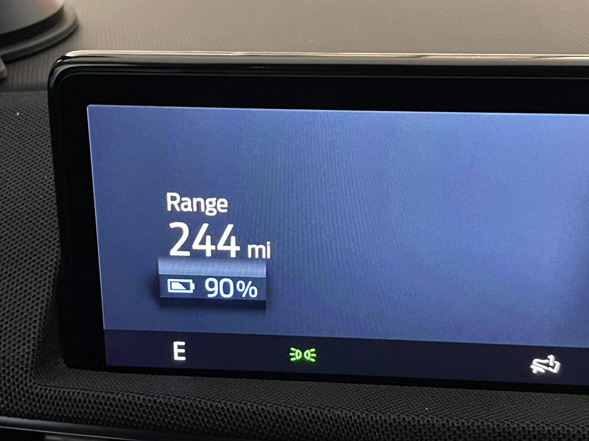

Man my stupid GoM is still SOOOOOOO incredibly far off from what its supposed to be after resetting it this past Friday. I would had thought it would had gotten a little more realistic by now, its not even in the ballpark.
Ford Mustang Mach-E Always plug in in your garage? 1637111908974
Far as my driving history, 4,678 miles almost 24hrs and my average is 3.9 mi/kWh. So its not like I drive the car like I stole it. I actually drive really conservatively, and to be honest that 4,678 miles has me stomping on the accelerator a lot cause it was new and fun :) I don't really punch it much anymore.
Has the trip2 mi/kwh ever shown anything other than 3.9? The reason I ask is that there's a bug in it; if you hit the "reset" button and it doesn't change the displayed mi/kwh to 99.9 then the value it does display is "stuck" there. Also, the clock value never goes over 23:59, it just rolls over to 00:00 because it doesn't display number of days. Sorry to rain on your parade, but it's likely neither of those "lifetime" values is correct.

I drive about 43 miles to work each day about 50/50 freeway side streets. On the freeway I have the car set to 75. A large majority of the time when I get to work I’m sitting around 4kWh sometimes I get up in the mid 5.
Where I’ve not tried resetting it, I feel pretty confident it’s accurate just from my daily current trip stats. That said, I know even that can be wrong sometimes, but I get pretty constant numbers. Guess I need to just charge it to 100% and track the mileage and see.
