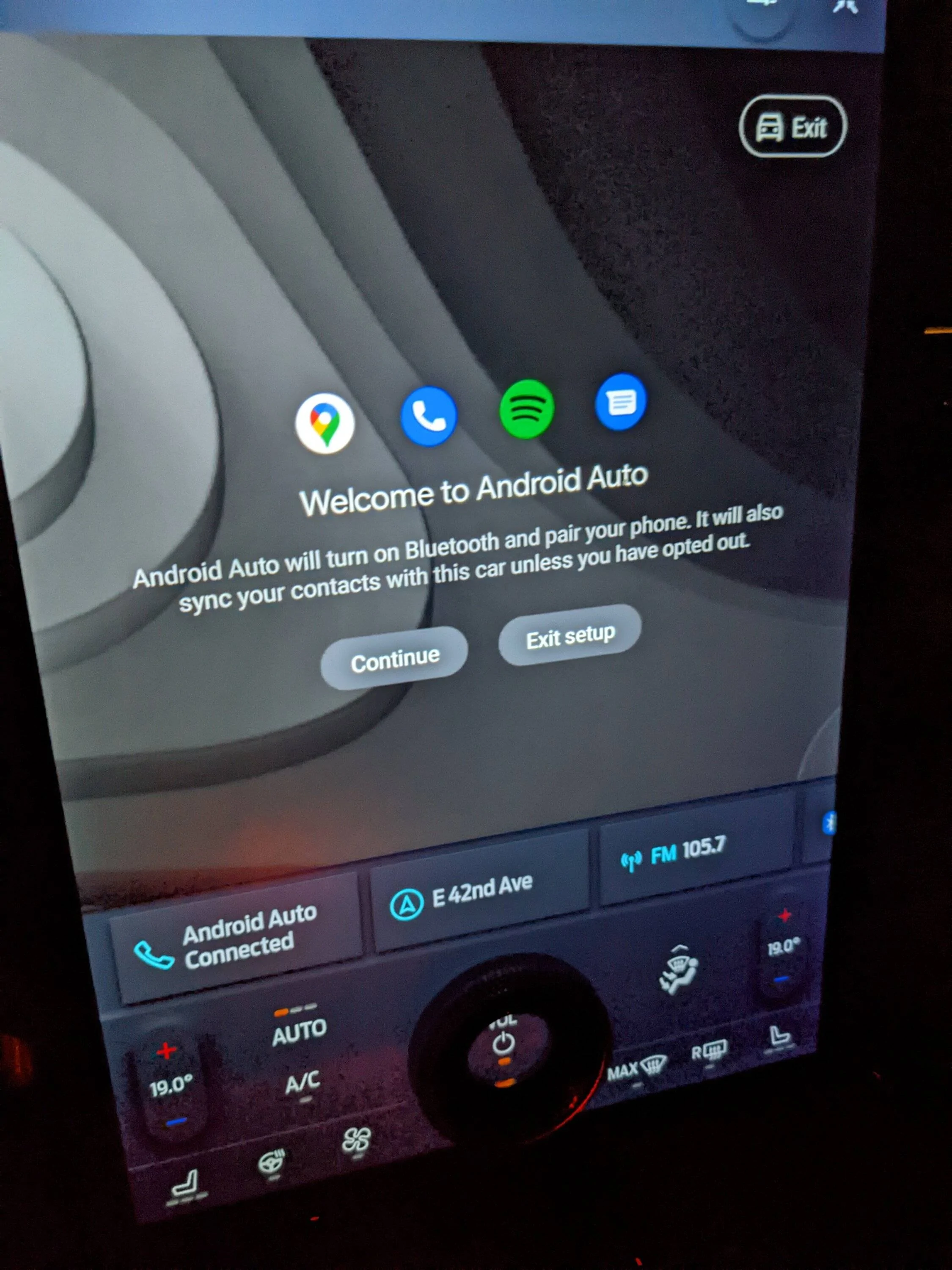

After the 3.5.4 OTA, AA stopped working for me as well in that it wouldn't launch on the MME. No joy rebooting the phone and/or Sync.
Had to forget BT on the phone, forget BT on the car, uninstall and reinstall AA on the phone, pair up the phone with the MME on BT like it was de novo. Then I could setup AA afresh and have it work.
Thanks for your recommendation! I uninstalled and reinstalled AA. I also noticed there was an update to AA. So I don't know what did the trick, but at least now I have wireless AA back in working order.
