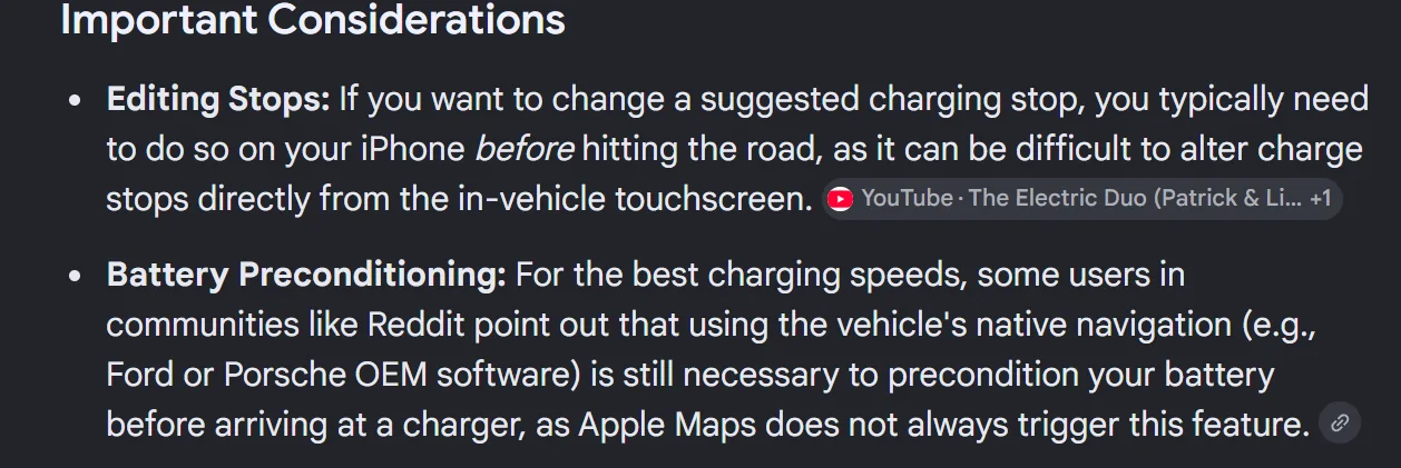

You can edit charge stops in Apple Maps on the phone before starting navigation, but not on the CarPlay interface.
Ideally on a trip you would pay for a charging subscription for lower rates (eg Tesla or EA) so just select that one as your only preferred network before starting. It doesn’t make financial sense to be hopping between different networks for each charge stop.
The EV routing in Apple Maps does have a lot of room to improve for sure. It’s only available on a handful of EVs so there may not be a lot of development resources dedicated to that part of the app. There really should be a universal standard for that…
