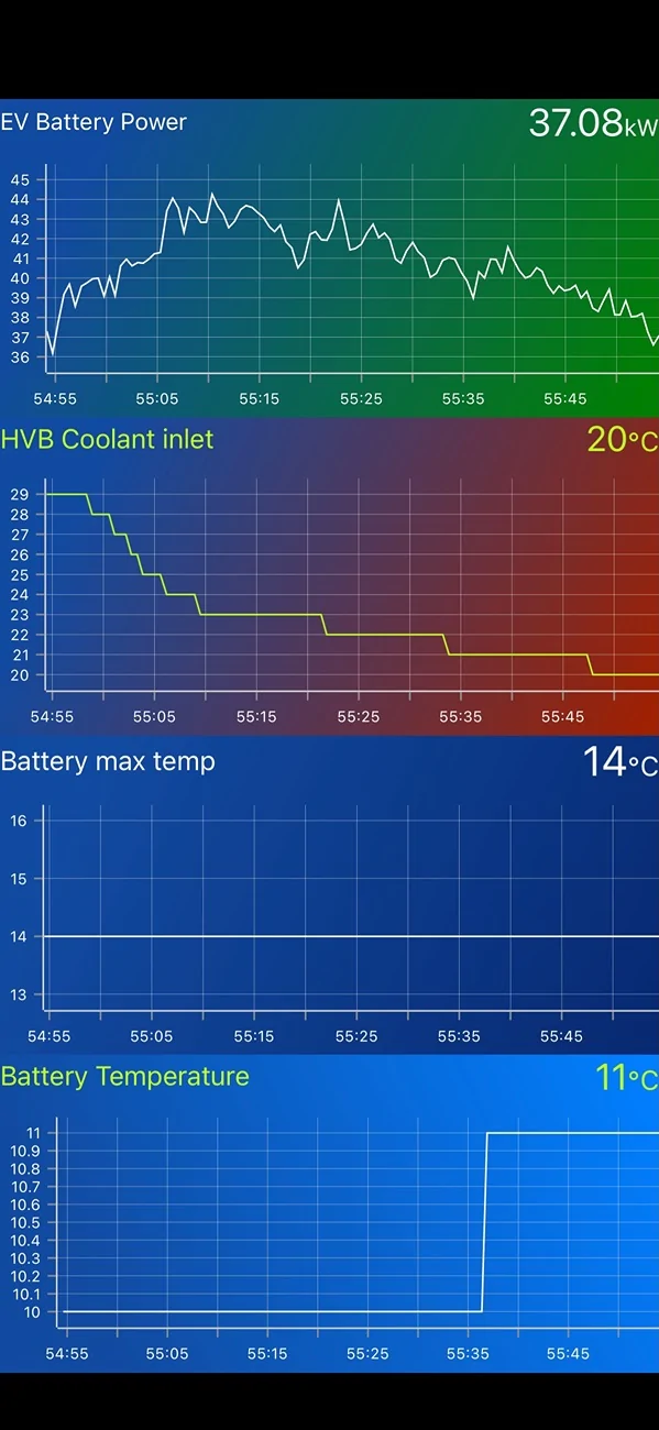

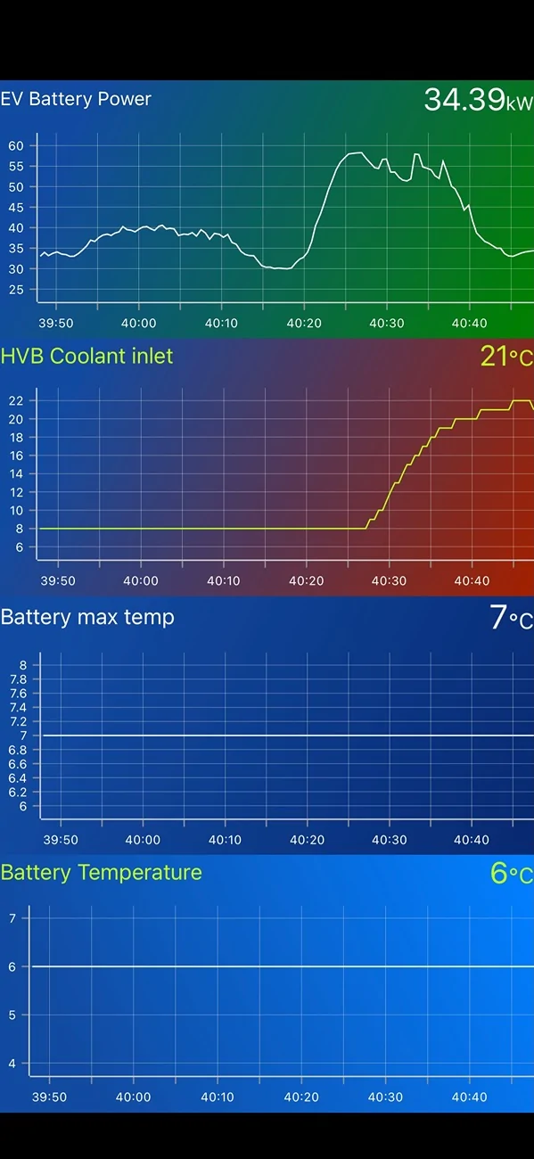

It worked! On my way from Calgary to my home in Canmore I put the Kananaskis Tesla Charger in as a destination. This charger doesn't have a Magic Dock. Nonetheless, Connected Navigation recognized it as a charger, and put the little charging station icon next to the remaining distance in the IPD, in my 2022 GT. I believe that there's no way to get Connected Navigation to use this station in the Trip Planner, since there's no toggle switch to indicate that I have a NACS Adapter, but nonetheless it's clear from the IPD that Connected Navigation knows it's a charger.
The first image is 30 km before passing the Tesla charger. Suddenly the HVB Coolant Inlet temperature rose to 21C. Second image is immediately after passing the Tesla charger, immediately after changing the destination in the navigation to be my actual destination. You can see the battery was warmed up to 11C (battery max temp 14C) and the coolant inlet temperature started declining. Third chart is the whole trip, you can see the inlet temperature spiking up what seemed to be every 5 km (30km at 21:18 this evening, 40min and 30s into the trip, and again at 25km, 20km, 15km 10km 5 km and perhaps 1 or 0.5km) but I suppose it might have been on a ~2min time schedule not a 5km distance schedule. You can see that the HvbMaxT ("Battery Max Temperature") rises dramatically(to 15C), while the HvbT ("Battery Temperature") rises to 11C.
I expected the battery temperature and the battery inlet temperature to fall more dramatically after passing the Tesla charger and changing my destination, but maybe once everything is warmed up it stays warm.
The ambient temperature on this trip was mostly 8C. I don't know why the battery started out so much colder, at 4C, perhaps it was still cold from the night before. I also don't know why carscanner didn't record the ambient temperature! Anyway, it seems like the car was putting virtually no energy into heating the battery until 21:18. It looks like it might have even decided reduce the HVB coolant Inlet at 21:16 in anticipation of spiking it starting at 21:21.
This is pretty solid evidence that if you put a Tesla charger without a Magic Dock in as a destination in the Connected Navigation, and the IPD shows the little charging-station icon next to the remaining distance, the car will precondition for that charger, even though it can't use that charger in trip planning. Hopefully others can repeat the experiment.
