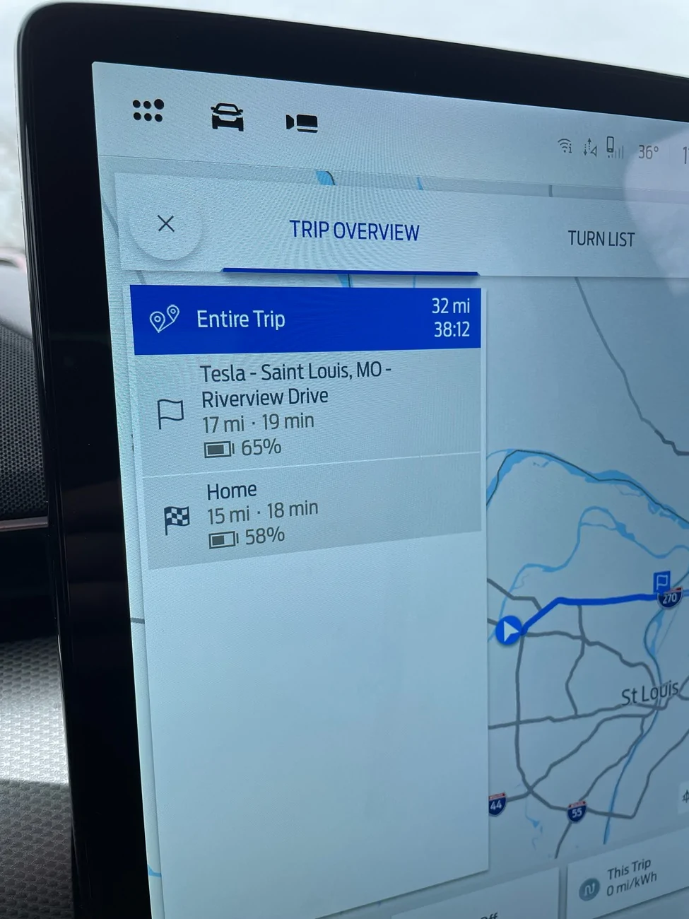

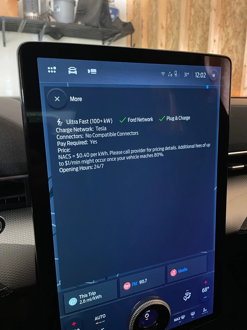

If I search for a Tesla supercharger, I can get some info on it and I can navigate to it. Does the fact that it shows the little charging icon mean that it will precondition if needed?
If you’re using a 2024 or earlier, those are magic dock stations. That’s how it works for me. And when I navigate to one of those magic dock stations, it preconditions.
This makes sense based on what I’ve read here. The missing piece in our cars is an “adapter needed” concept. You don’t need an adapter for magic dock stations.
Yeah, that’s how I understand it to work. I’m in a 2021. But neither of the superchargers in the pictures are magic dock station. The one I navigated to is the one on Riverport Dr. in St. Louis and the one showing the info is in Galesburg, IL. I’ve used both of those stations and neither are Magic Dock. You can even see the Galesburg one says “Connectors: no compatible connectors.” All I did was search for “Tesla” at some of the locations I’ve been to and know aren’t Magic Dock.
