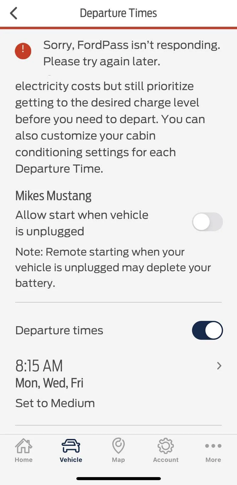

Id like to remote start just before I leave work. There is no plug at work so I tried to allow remote start when unplugged but ever since getting the car a week ago whenever I try to do that I get “Sorry , Ford Pass isn’t responding try again later”

That setting is for automatic starting for scheduled departure times, but there’s a bug that’s preventing it from being enabled. Is that what you’re trying to do or are just trying to do a manual remote start?

Mines doing the same. I have a ticket in for it right now with fordpass. Can’t believe they still haven’t fixed it
I am just trying to allow manual start
Okay, then you don’t need to enable the setting in your screenshot. Do you get the same error when you hold in the Start button on the main screen? How about remotely locking and unlocking?

You need to remotely lock your car and hold down the remote start button on the fob for about 5 seconds

It turns out I can remote start the car even though i can’t access the settings on that particular screen. Problem solved I guess. Just another bug in the app they need to work on.
