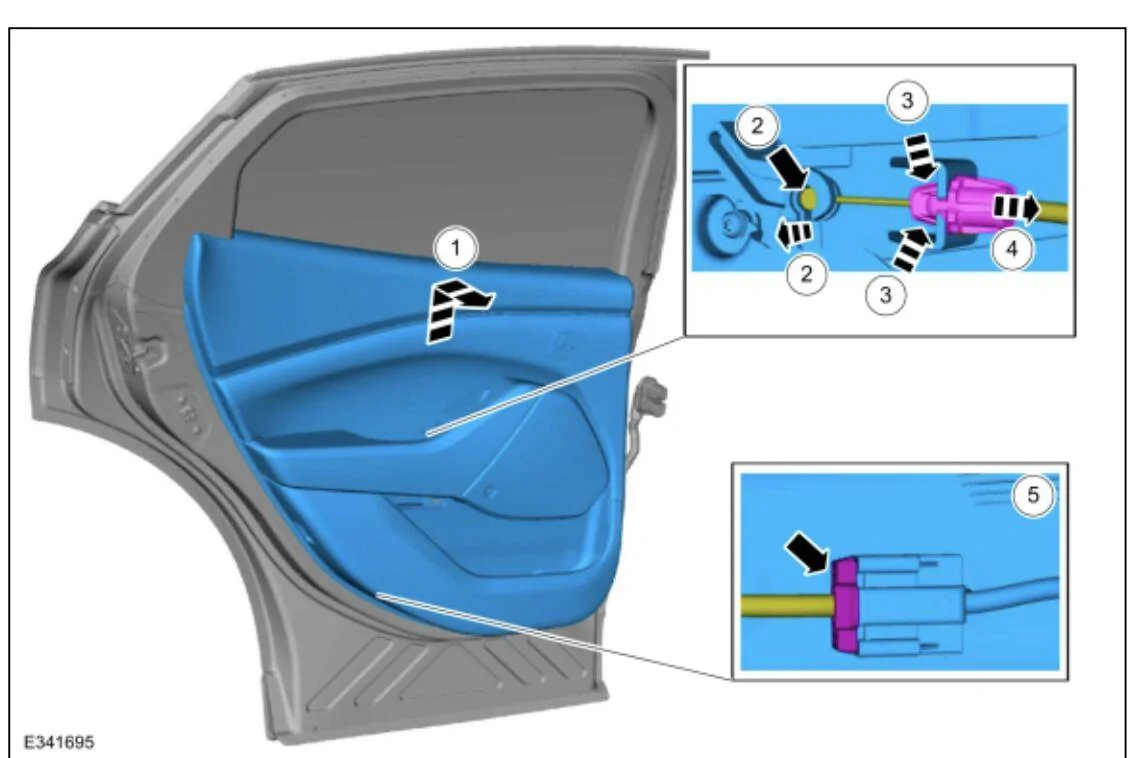

Here are some notes from the work shop manual (WSM). It looks like there is a rear door interior cable, however still an electronic interlock if the child lock keeps the rear door handle from opening the rear door from inside.
Each door latch control module has an internal power backup, allowing the door latch release to function for approximately 20 activations or 72 hours after, a power loss (such as a disconnected or depleted battery). page 3410 WSM -> Thinking back to the early dead 12V LVBs, I recall a number of folks reported not being able to open the doors, I think well within 72 hours (probably next morning after sitting overnight), so I'm skeptical of this section in the WSM. As I noted earlier, I did see doors open several hours after the LVB was disconnected, but next morning might be doubtful. Maybe this is the supercapacitor question, where many thought it never got implemented. Or, something discharges the backup power much faster than expected.
The BCM sends voltage signals to the rear door latch control modules. When a rear door latch control module detects a lock or unlock request, it grounds the respective voltage signal from the BCM to lock or unlock the doors. When the BCM receives a valid lock or unlock request, it provides a voltage signal to the door latch control modules to either lock or unlock the door.
The door latch control modules also provide an unlock override feature in the event of a severe crash event. Depending on the severity of the crash event, the RCM provides a network message and wired voltage signal to the door latch control modules. Approximately 10 seconds after the door latch control modules detect this input from the RCM, they enter a crash unlock mode to allow the doors to unlatch from the interior door handle or front or rear exterior door latch switch. The crash unlock mode is exited by cycling the ignition on and off twice. page 3411 WSM
Ford Mustang Mach-E Back Doors Won't Open from Inside Screen Shot 2022-08-24 at 2.59.30 PM

Looks like in a crash all doors will be openable...
