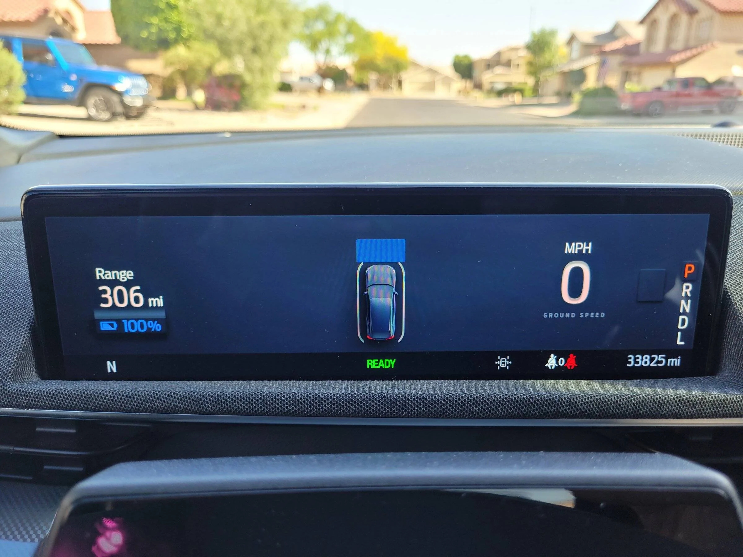

Someone in the forum mentioned that they spoke to one of the Ford engineers and according to them, if you charge it to 100% then the regen braking has no way to put energy back in to the battery because is already full. ...
That is a good example of mis-information spread by agents of the company that didn't quite understand what the engineers are telling them. They repeat what they heard vs what was actually told to them.
The user can't charge to 100% so the issue with regen doesn't apply.
I see Max Regen Enabled (via scan tool) even with battery at 100% displayed. (which of course is NOT 100% actual).
