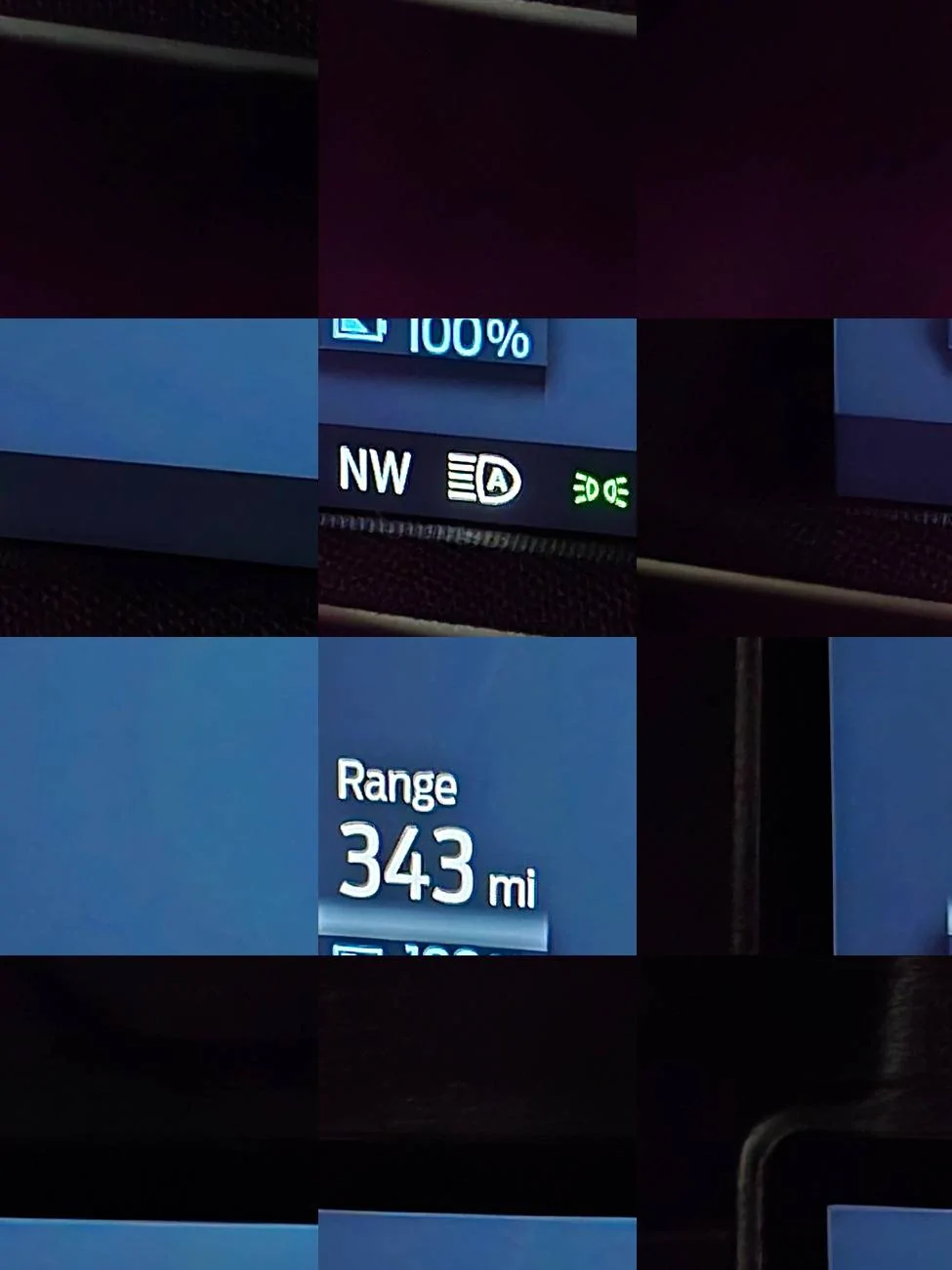

After my normal everyday driving> The GOM was reading 343 at 100%, prior to a road trip. After the road trip reads 312 at 100%, It adjusts based on your driving history,
