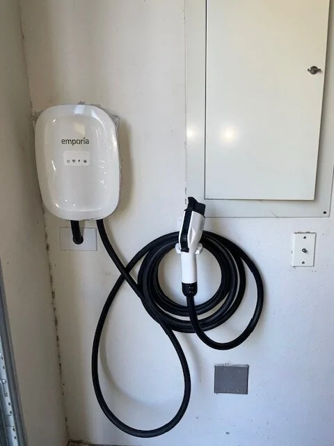

Charger at home, I don't use the unreliable Ford mobile charger. Mine is a wall mounted hard wired EVSE at 48A (11kW) for maximum efficiency.

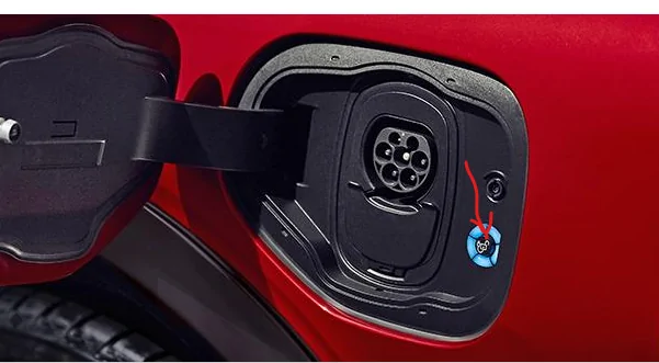

As for the disconnect, L1 and L2 chargers do not need to be released/unlocked.
Only at a L3 (public DCFC) you will need to press the button in the center of the blue/white lights, to disconnect.
My L2 charger at home - shared between 2 EVs:
