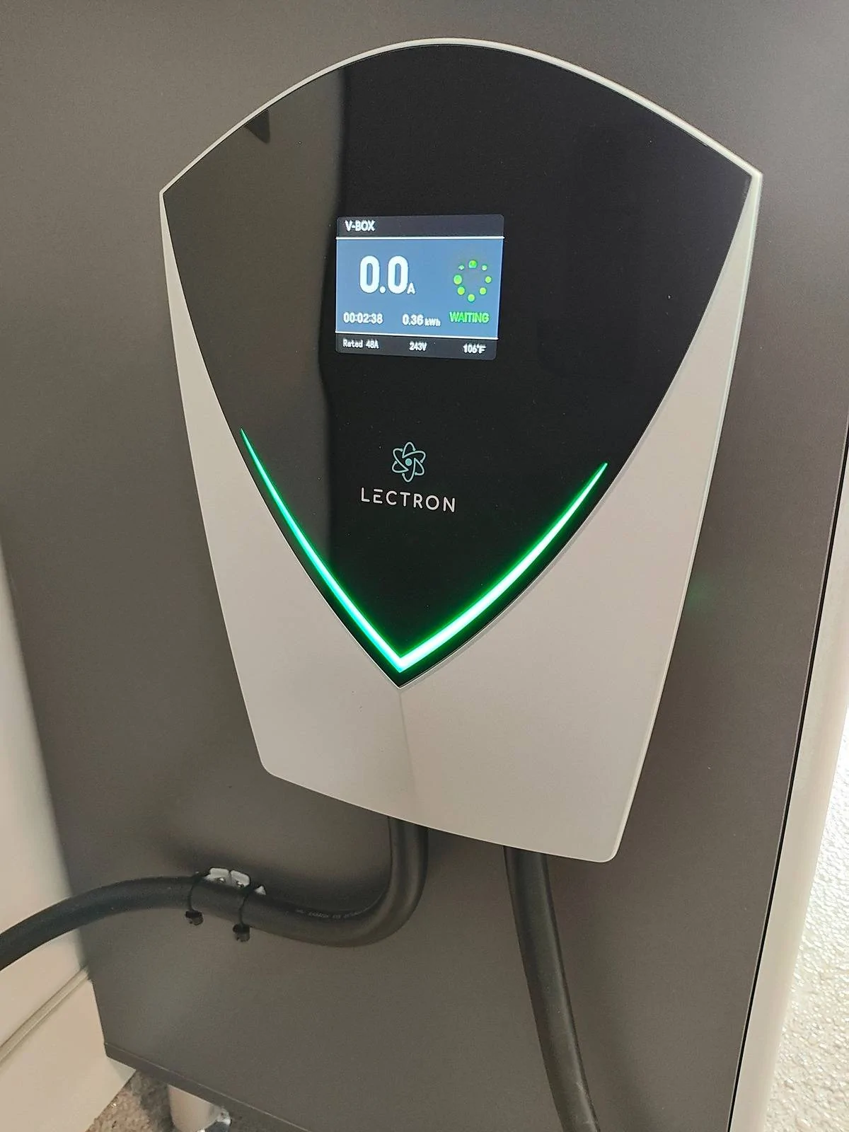

I have been using the Lectron V Box for almost two years without any issues. The model I have shows the Kwh that are transferred to the battery which I like as well as the temp, voltage etc. You can set it to what ever output you like. This is a page on Amazon with most of there models. https://amzn.to/4ag58rI
