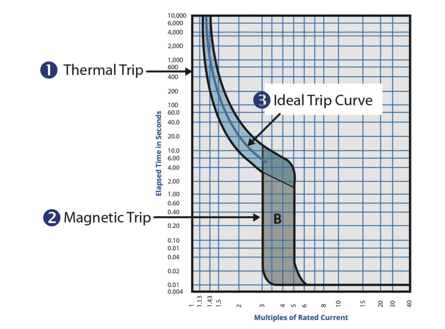

The only thing I can add to The General's response is to answer your question about the 80% "rule".
A 50 Amp breaker won't blow right away if you run 50 Amps through it; however, eventually it will. The breaker is only designed to handle 80% of it's rating if the current is steady, like when charging a car.
That is why a 48 Amp charger requires a 60 Amp breaker. And a 60 Amp breaker requires wiring that is rated for 60 Amps. And there are no outlet/plug combinations that are rated at 60 Amps for residential use. Which is why all 48 Amp EVSEs must be hardwired.
I have a hardwired Emporia charger that is 48 Amps. There are a lot of 48 Amp EVSEs available.
A breaker should carry 100% indefinitely unless some other parameter is out of spec. The NEC 80% requirement is not due to breaker trip curves. Here is a typical residential breaker type B curve:
Awesome correction! Thanks!

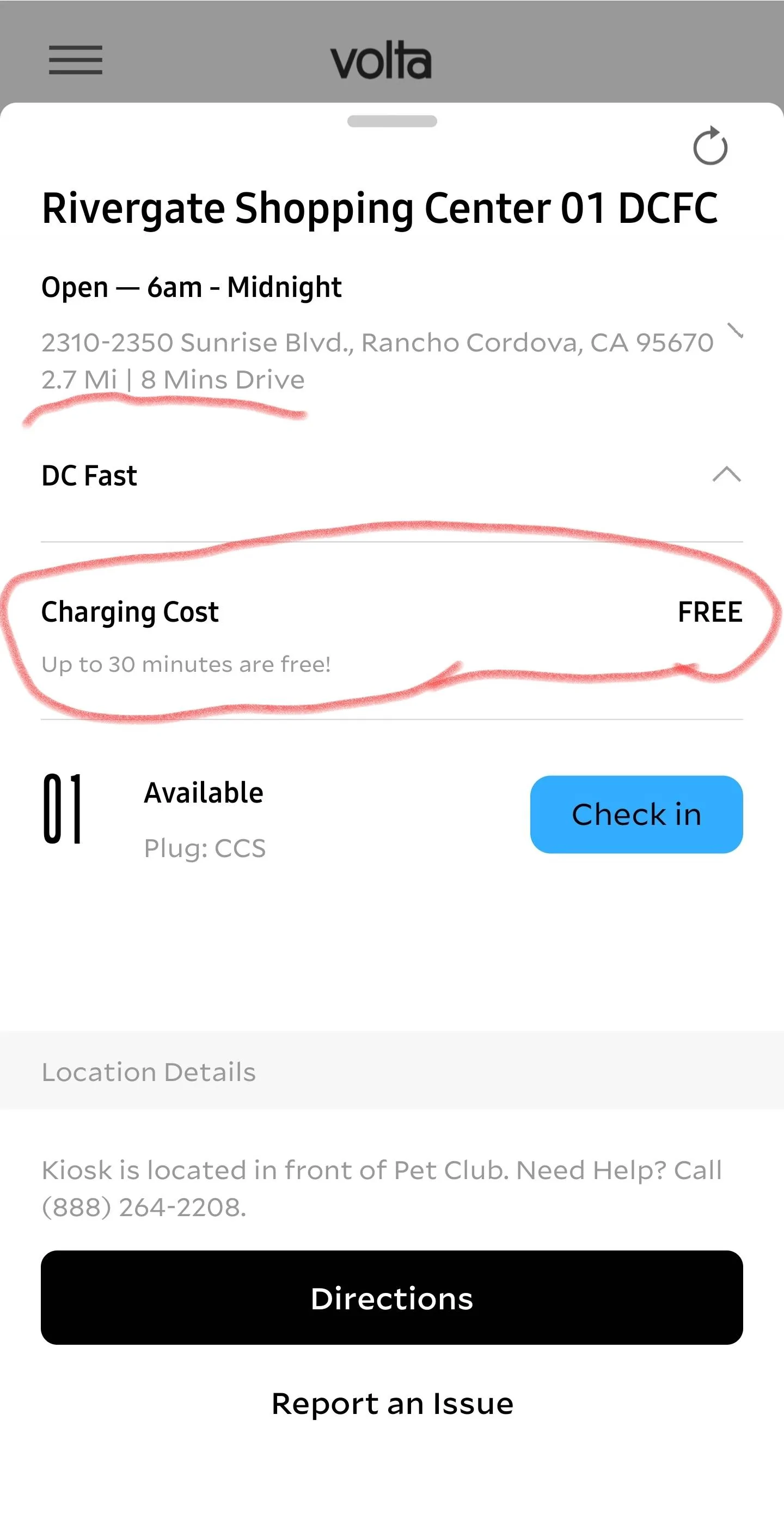

I was just at a store I often go to (2.7mi from home) and saw a dude using the Volta DCFC. Since he was chillin with the window down I asked what the rate ($) was for using it and he said "free". I said oh you have a network plan with the car (BMW)? He said no, you just get the Volta app and it is 30m free.
There has to be some catch? But there isn't!! I scanned around from Sacramento to Santa Cruz and the only free Volta DCFC's are in Sac right near my house. Nearly everything else is a Level2 or a DCFC that is not free. For example that one in Santa Cruz is 39c/kWh and 50c/minute after charging stops!
This one is insane as I easily just spent 30m at the Pet Club and Smart & Final it is in front of. Very happy to see it as an option if ever needed.

It's been like this ever since they launched their first DCFCs. Used it a half dozen times; always reliable, never had any issues activating. Part of the reason I'm able to easily charge even without at-home charging!
