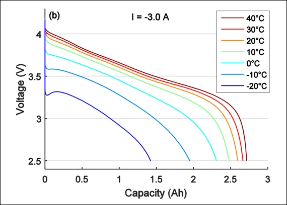

It's still the same issue: the electrical potential stored in the battery is hard to measure exactly, and it changes with temperature. While liquids can expand and contract slightly, generally speaking the effect is minimal and their volume is easier to measure than electrical energy. The fact that the state of charge is given in percentage points gives the illusion that it is measured more precisely than it actually is - they probably should have stuck with a gauge that reads in eights and everyone would be blissfully unaware.Yes but ours is the other direction. I charge to 80% but when I go leave for somewhere it is actual at 82 or 83 according to the car
That means the battery pack is cooling off. A colder batter has less capacity so a specific SoCD will be higher if the battery cools. That makes sense. Less SoCD when the battery cools does not make sense to me.Yes but ours is the other direction. I charge to 80% but when I go leave for somewhere it is actual at 82 or 83 according to the car

Preconditioning consumes kWh faster then the EVSE charges, therefore at the immediate end of preconditioning you may have lost SOC before giving it time to replace the kWh used.Thanks. That makes sense. I have recently started to delay my charging to like 4am since I usually only need about 10% to get to my target. Thinking was that if I delay to charge till early morning, the charging will warm up the battery and not need as much preconditioning.
But what doesnāt make sense is that if the battery cooled off and now the percentage is a tad lower, seems like the charger should recognize that and top it off since Iām still well within my charging time window.
