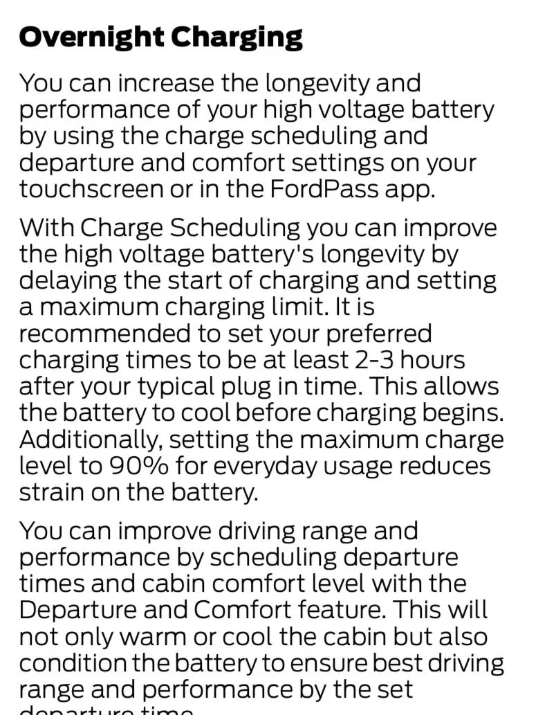

Manual says best to wait several hours and reasoning it gives it “to cool”.
Manual is not correct, battery temp does not appreciably increase while driving if you monitor it. That is likely a copy/paste from a hybrid manual, those do warm up their batteries quite a bit.
