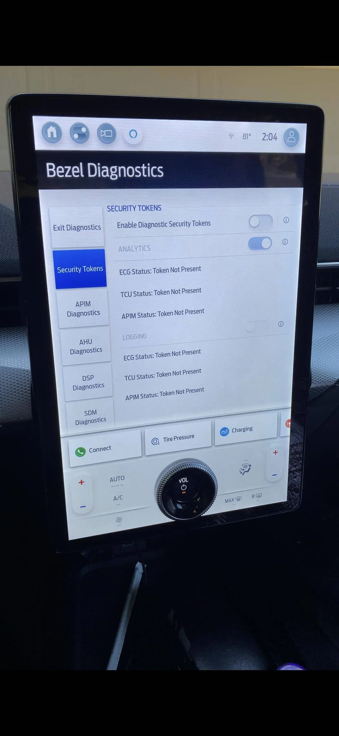

My center screen has been failing to load intermittently (even preventing the backup cam from displaying). Today I remote started the car and the center screen failed to load and the AC was not working. When the screen was black I pushed the power “button” several times and it immediately opened to a diagnostic screen. Anyone know what triggers this screen and why it might be related to my screen staying black. This issue started after a couple updates 2-3weeks ago

Sounds like you discovered a diagnostics trigger that works while the screen is restarting.
The other way to get there is to bring up FM radio, then hold the steering wheel's volume down and prev track buttons for several seconds.

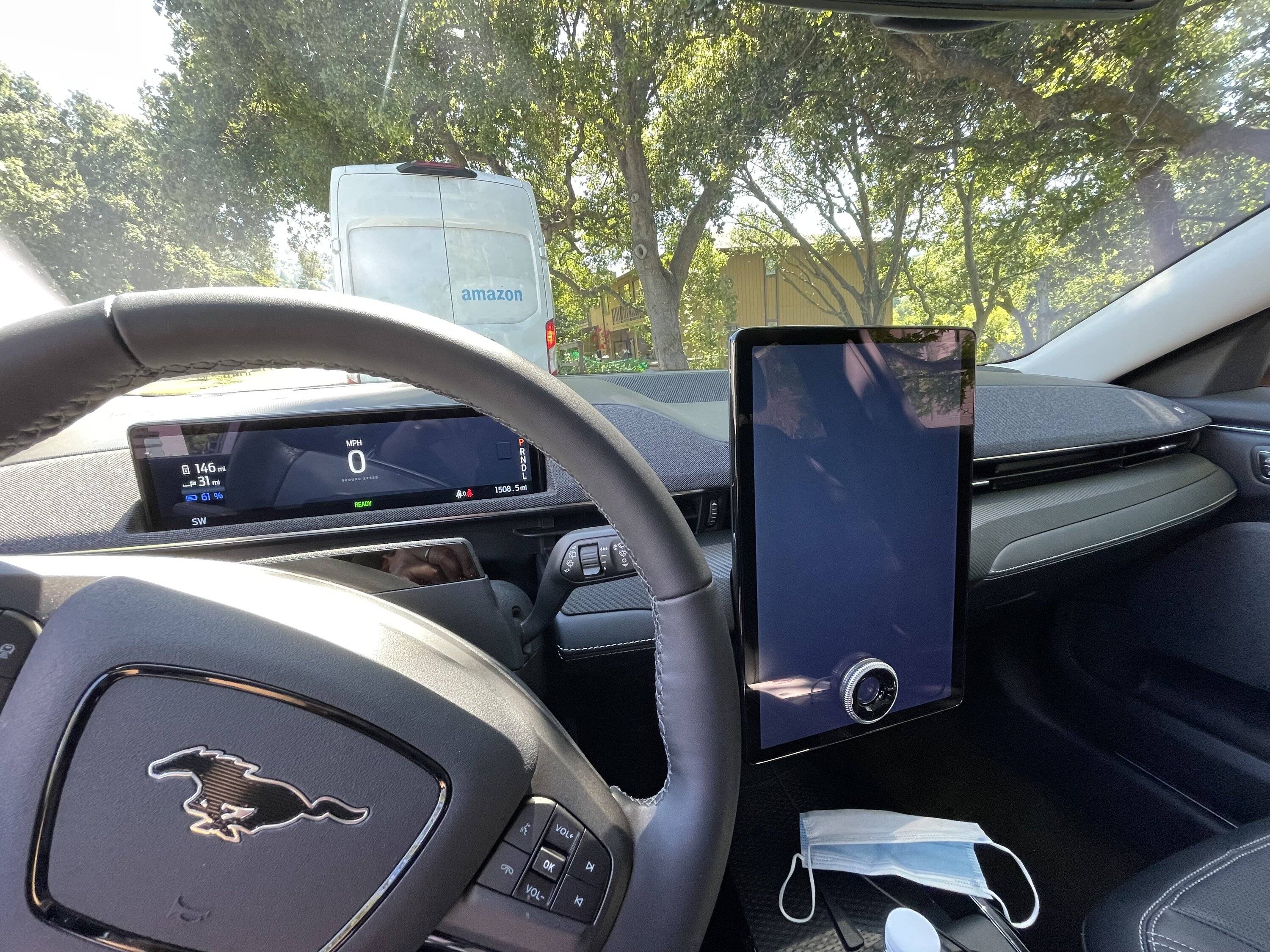

Are we sure it's not an overheating issue? Car was fine this morning and right now:
Display booted after running the car a couple minutes. Outside temperature says it's 93F (34C).
I don’t think so, 30-60 seconds isn’t enough for the screen to cool down. Mines also done it at 5am so It can’t be that hot lol.
No it's something else... Also, 93F is NOT HOT... ?
