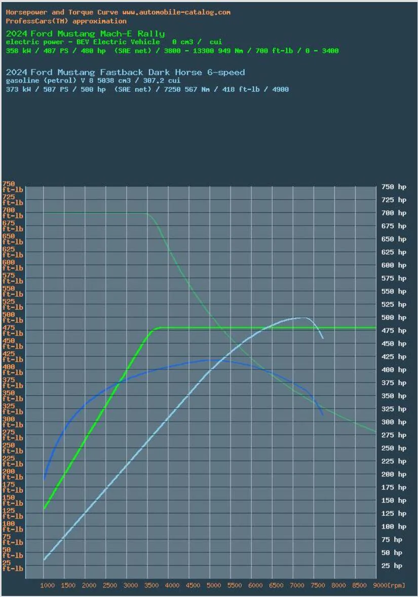

Before I got strung up on here, I googled the MME GT torque curve and went by a realistic image. I did no additional validation or fact checking, but that image showed 700 from 0 to 3500 then it drops almost at 45degree angle, but HP rises in that span so you start to feel that kick in.
There's a clear sweet spot for both torque and HP - it's just not as dramatic as an ICE power curve, so the benefits of a transmission are reduced, not eliminated
Ford Mustang Mach-E Blown away by ICE GT Fastback Screenshot 2025-04-08 110150

So, if I understand the graph properly, my assumption was correct. Both HP and torque are constant across the main operating range of the motor(s)?
Not quite - Torque is constant from 0-3800rpm or so (top line) after which it plummets rapidly, while HP rises until around that same point and then stays flat until rev limit. (The two swoopier bluish lines are the Dark Horse)
Yes, but that’s just a chart based on peak power numbers, not an actual Dyno graph.
We wish our hp stayed at the peak 480 number. In reality, it likely drops off much more than that chart shows.
Unfortunately no one has posted an actual Dyno of a GT and I think only one person has ever dynoed a premium 4x back in 2021.

Ah, that makes more sense

Ok, I’m confused again (sorry). I must not be reading the graph correctly. For example, it looks to me that the graph is saying that, at 3500 RPM, the Mustang Mach E produces 475 ft-lb of torque and 475 HP, at at 8000 RPM, the Mustang Mach E is also producing 475 ft-lb of torque and 475 HP?
