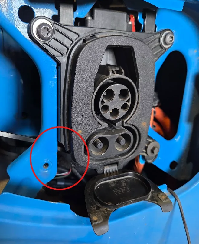

I posted before but the formatting was funny. Anyways, I have a pre-owned Mach E which appears to have been in a collision. I didn't notice the charge port was cracked until it was loose when attempting to use DCFC for the first time. Looking underneath the door it seems my bracket that holds the port in place is busted so it kinda wiggles.
Ford Mustang Mach-E Bracket for charge port same as F-150 Lightning?? 1775761450676-gf
I had to add a zip tie in a sort of circle around the back to pull the port into this bracket and so far so good, but a bit wiggly for my liking.

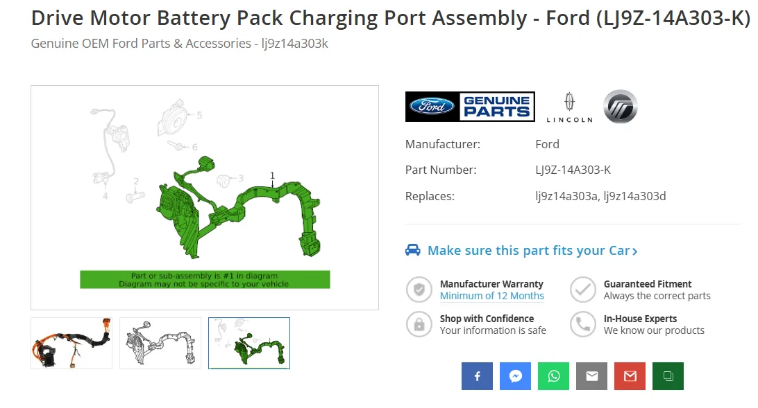

Looking at parts it seems you can only replace this with the entire harness. This seems like a pain to replace and expensive.

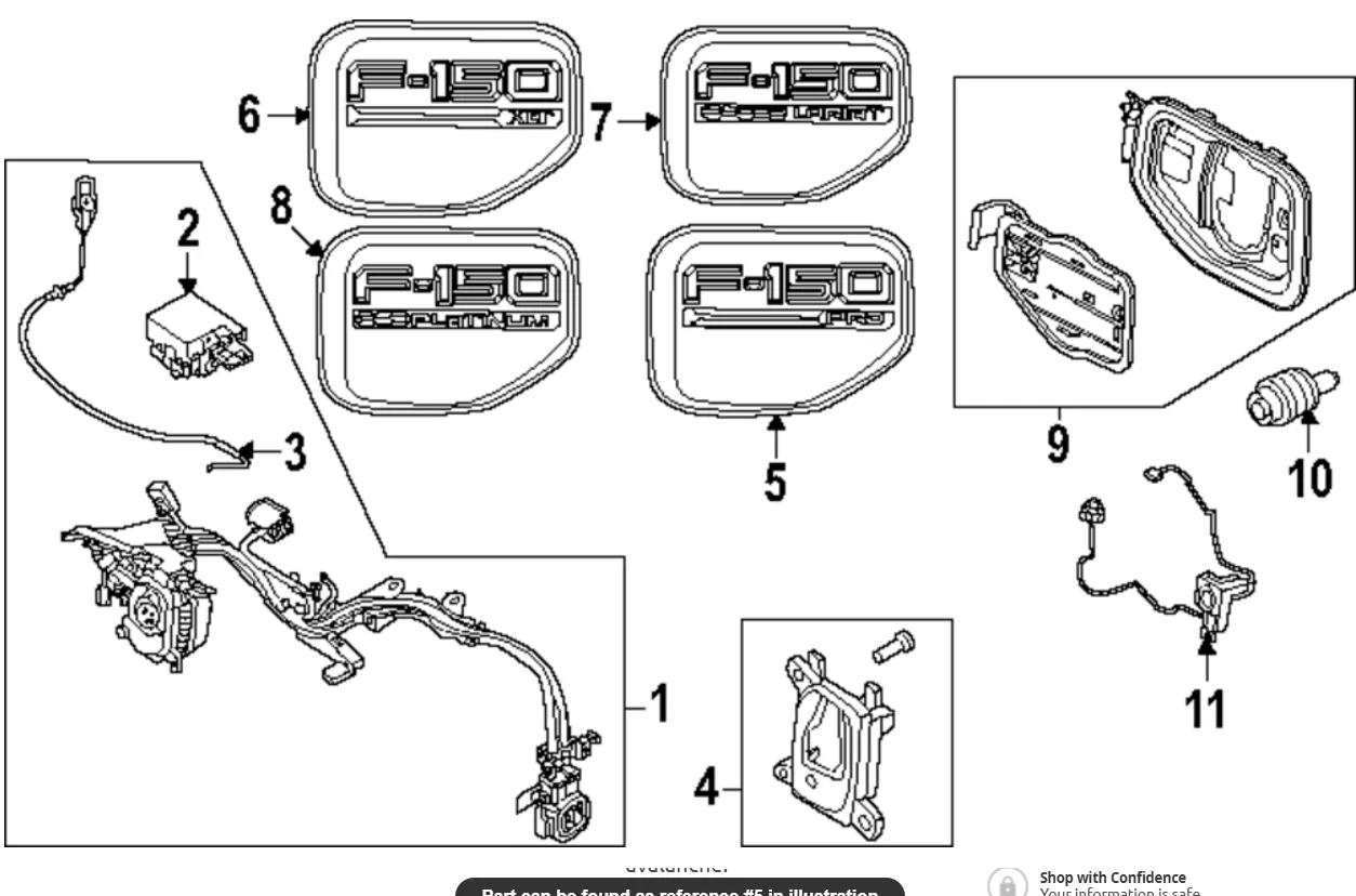

Here's where it gets funny, on the Lighting it says you can get it as a "flange" #4 in the pic below and about $50 bucks. Any idea if it is the same? It looks verrrryyy similar from what I can tell.
lj9z10e652a

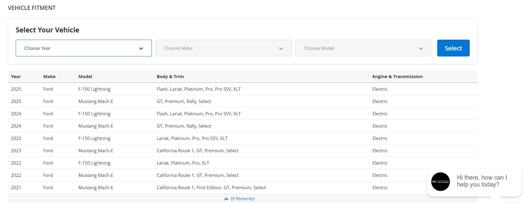

Might have answered my own question. If I search that number directly and check the fitment it says it fits?
Ford Mustang Mach-E Bracket for charge port same as F-150 Lightning?? 1775764895106-v4
They call it a
Anti-Theft Alarm Siren Bracket, Mount Kit, Flange
