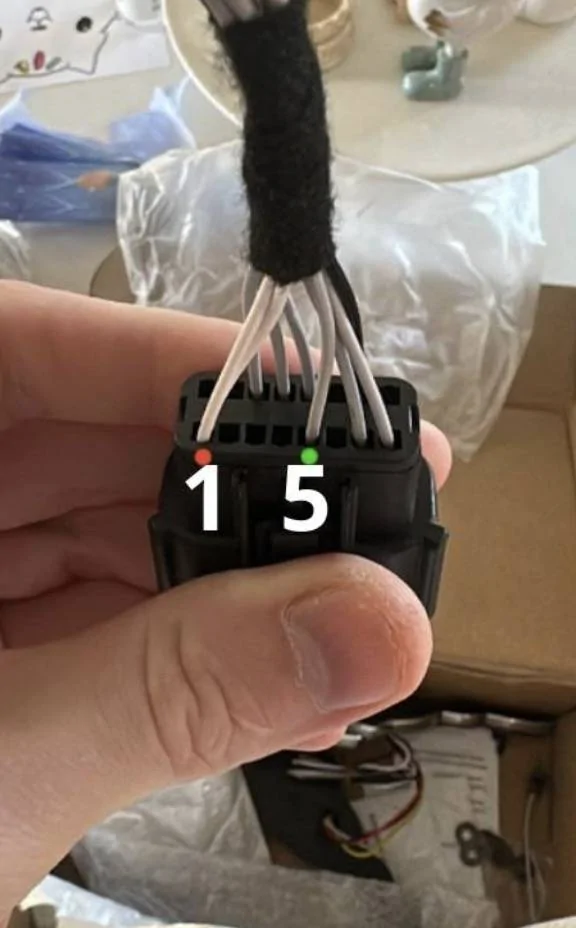

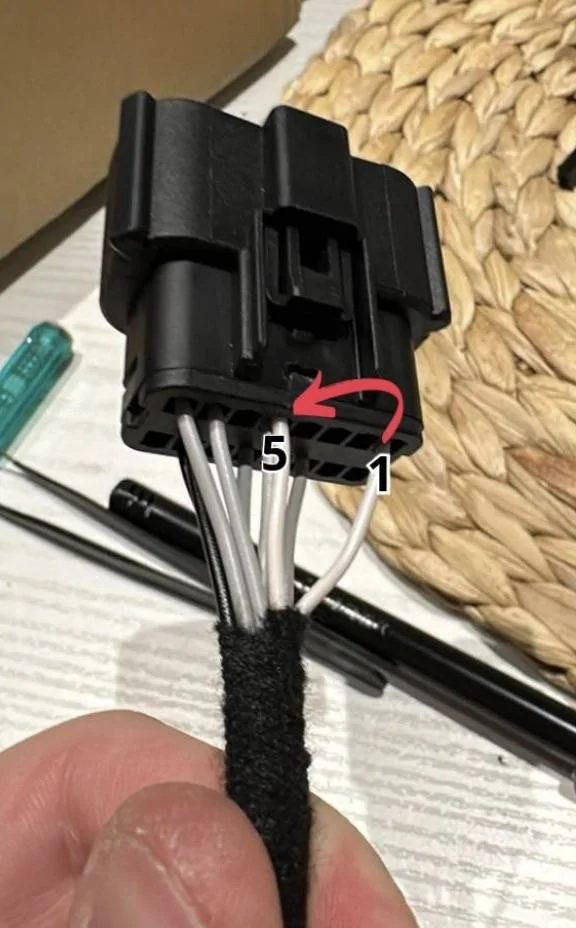

Do you know which wire to move?
There are two wires going into slot 1 in the connector. You need to move one of them over to the wire going into slot 5.
This is the old connector with two white wires going into slot 1 (hard to see but there are two wires there).

This is the new connector with two wires now going into slot 5 after one of them was moved over from slot 1.

Thanks. The wire that gets moved…is it the the that goes to the pony or the other one?
