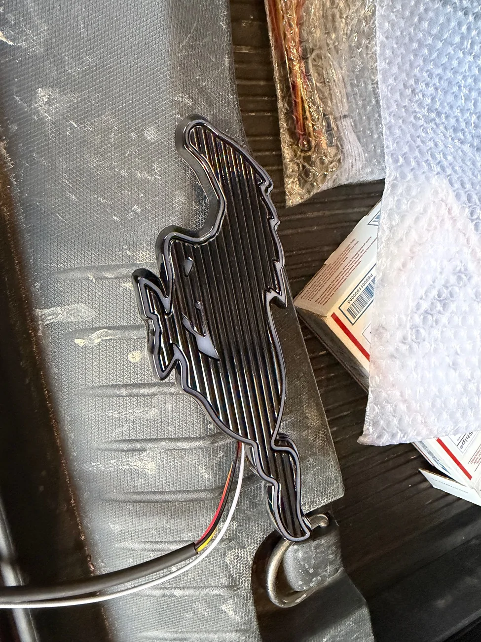

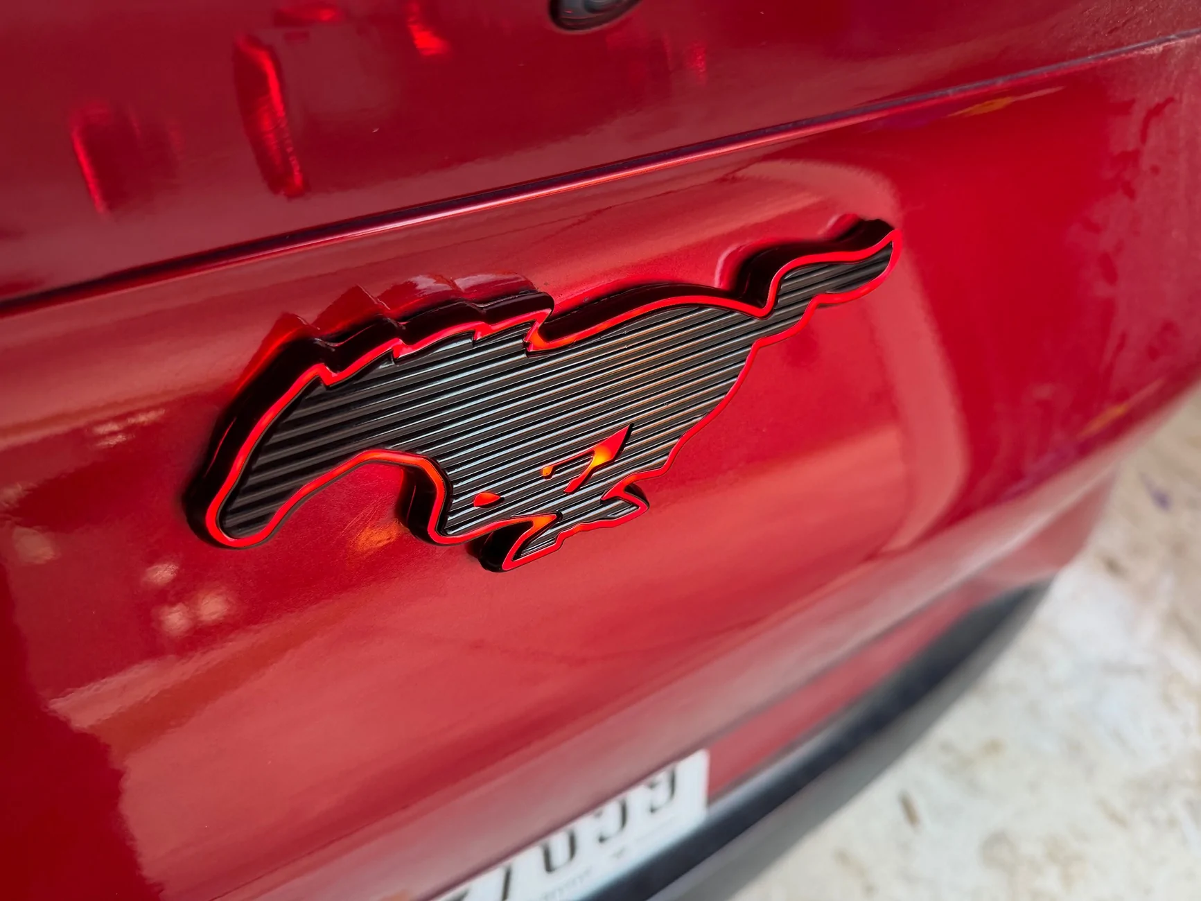

Update: I put in an order and the rear ultimate is already on the way. @Brucelan was getting back to me with questions in minutes and was super helpful. should have the new one installed next week. I will put some pictures here when I do to show everyone.

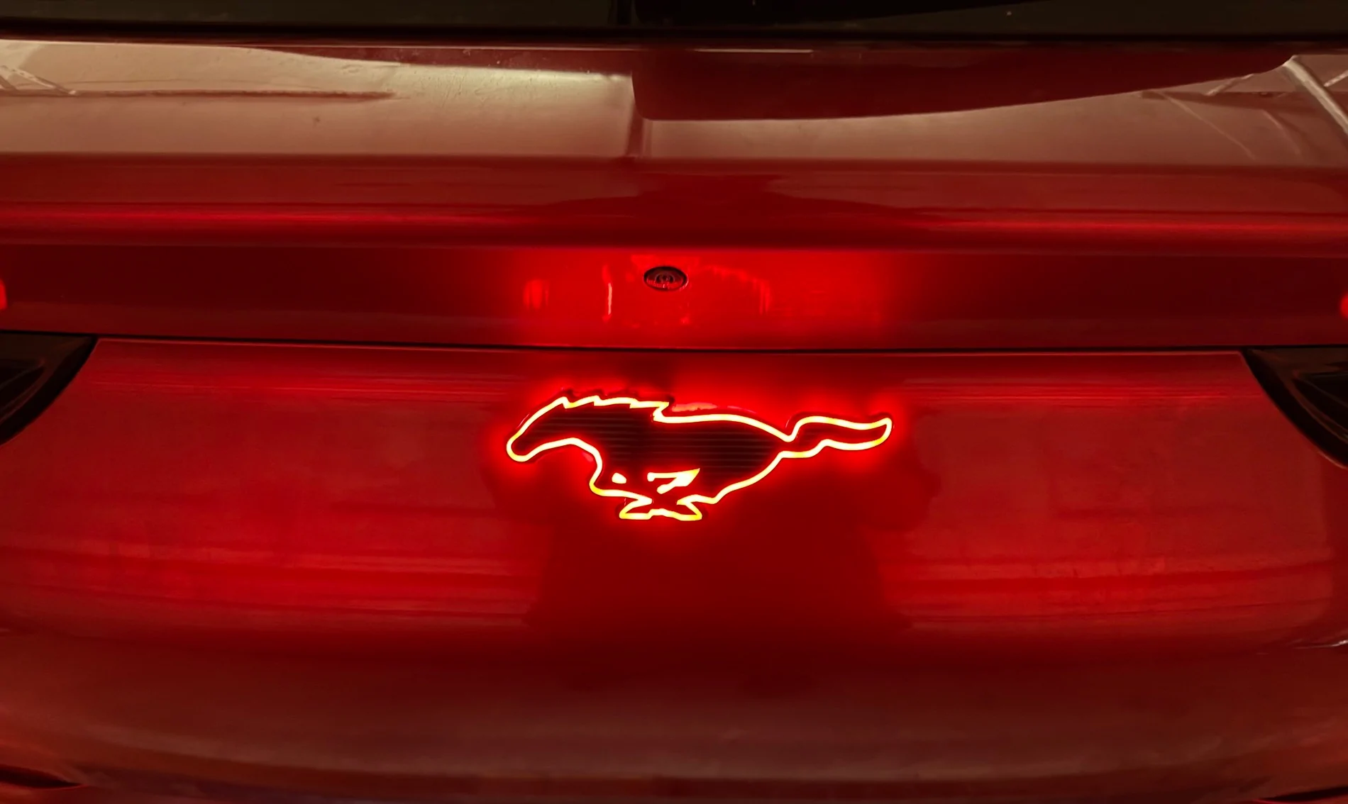

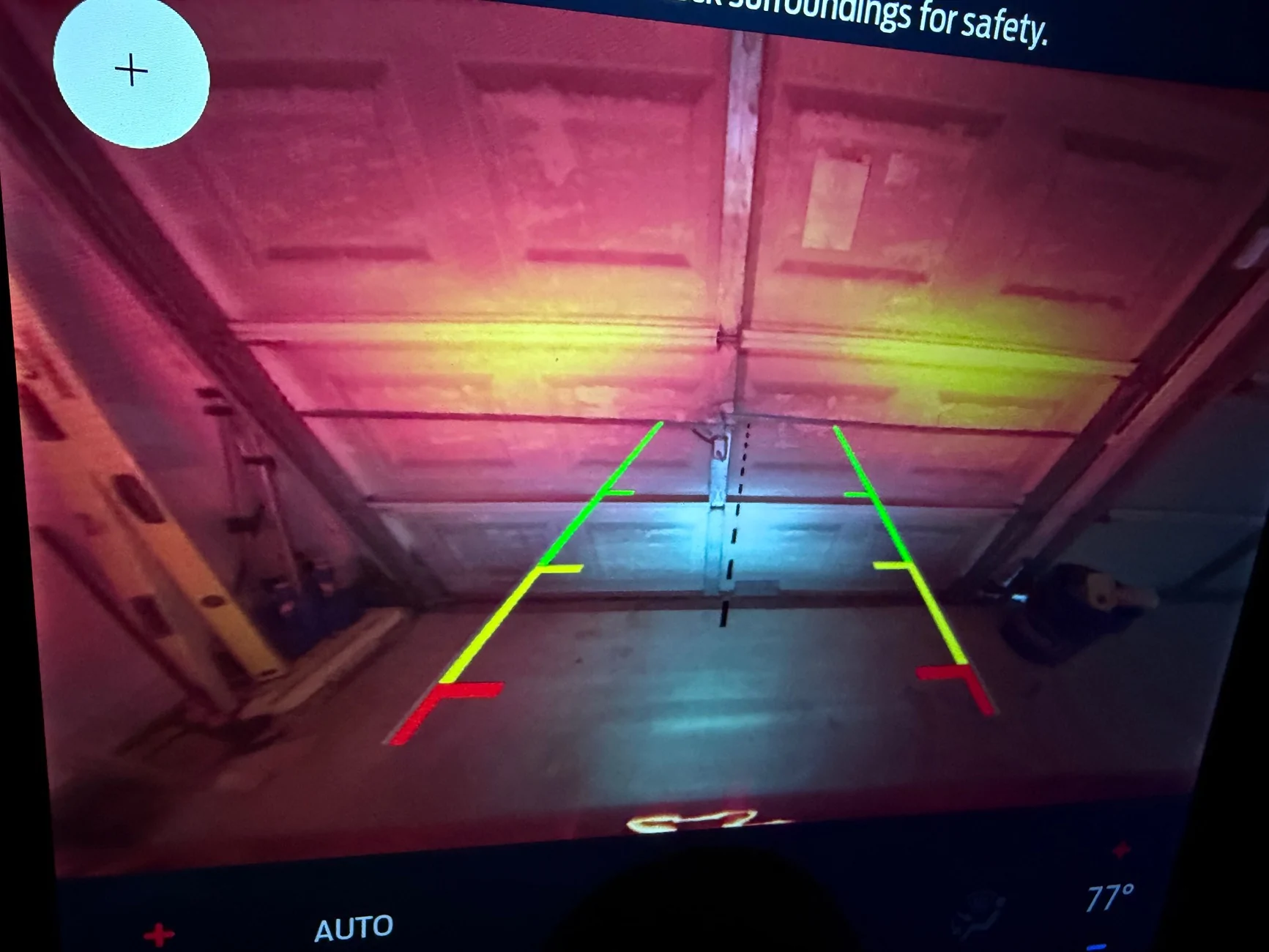

My overall impression: I really like it. I had tried to paint the top of my old pony to keep the glare down on the rear cam. The new one just works great out of the box. I haven’t hooked up the white light yet. On my old one I never bothered due to the interference with the camera. With this one being much better I think I will give it a shot.
