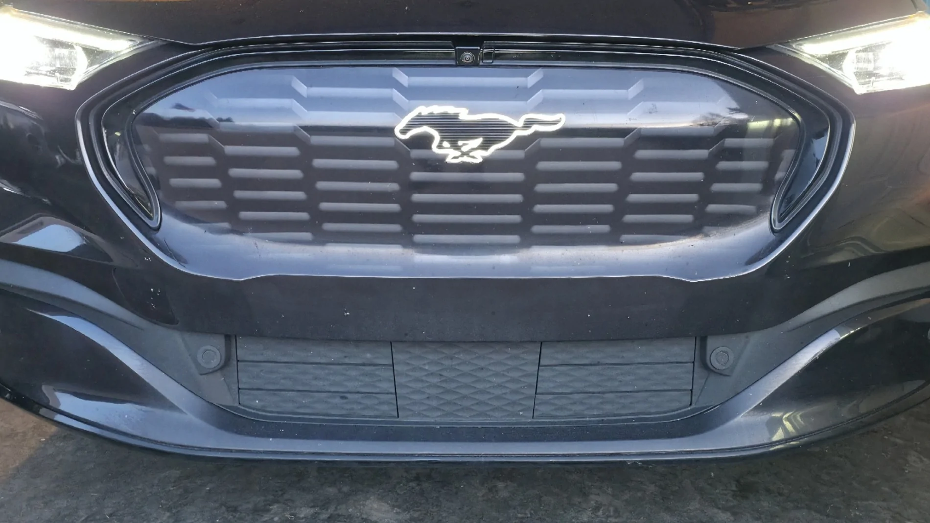

I got mine installed and it looks great. The soft start for the LEDs is really smooth and looks great. Make sure you use the new wire harnesses.

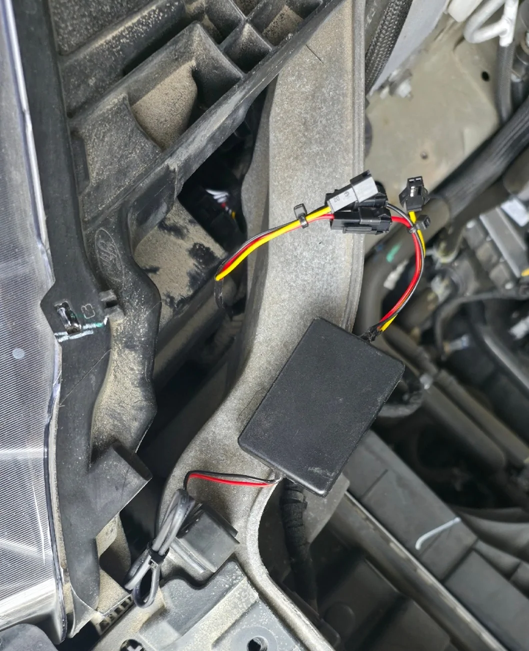

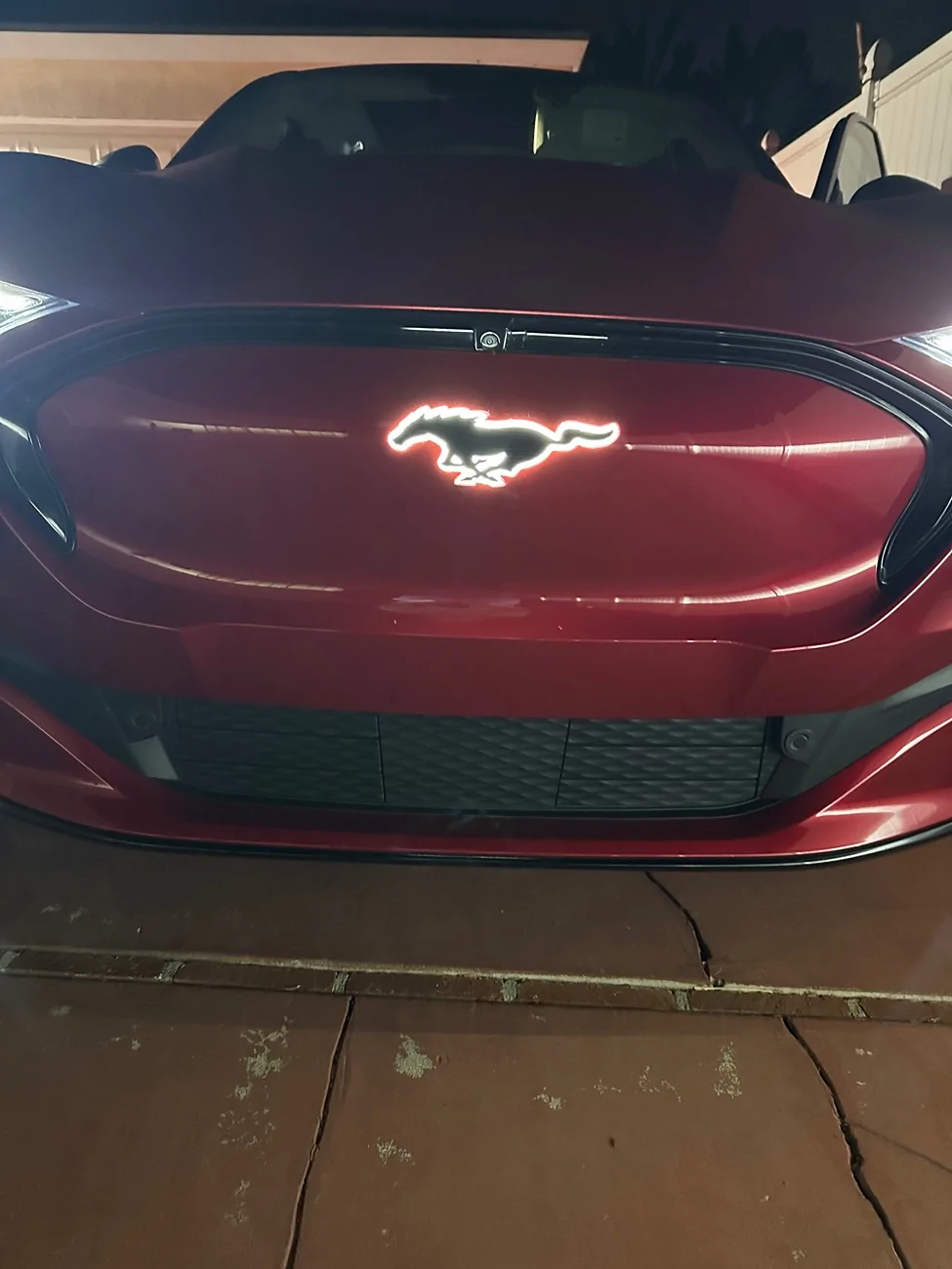

I installed mine yesterday. Probably the best mod I've done to date. I've never taken my frunk out before but I watched the video and it was an easy install. The video link was very helpful even though it was for the v3 pony. Because my Mach e is a 2022 the screws for the frunk were different but easy to find under the covers. The surge protection box and wire length is different too and I took a picture of where I placed it and tied it up in case someone else might find it useful.
Ford Mustang Mach-E BSKT Ultimate Project Technical review 20260411_174403[1]
It's right next to the passenger side headlight and fits perfectly in the space there to the left.
The pony looks great and I couldn't be happier with the support I received from BSKT when I had questions.
Ford Mustang Mach-E BSKT Ultimate Project Technical review 20260411_194330[1]

@lanebk I stuck my box in that slit too. It fits just perfect and didn't need to be zip tied or anything. Also, I went with the yellow wire instead of the red wire. Am I to understand if using the red wire, the pony is always on? Is that what you see with your set up?

Connecting the red wires only works on some models and years, mainly the earlier ones and pretty much most of the European models. Most people do connect the yellow wires and just have the pony light up with the headlights. If you really want to have the pony light up anytime the DRL's are on and connecting the red wires on your model does not do this, you need to run the supplied long red wire into the passenger compartment and tap into a particular wire which also tends to be different with various models. Most use the same wire but I have seen a couple of others that didn't. There will be one or two members on here that are going to determine what wire it is. Normally that is something I would do but I have a little to much going on right now working on suspensions to mess around with that. 😊

The red wire works on mine. But I have a 2022 4xe
